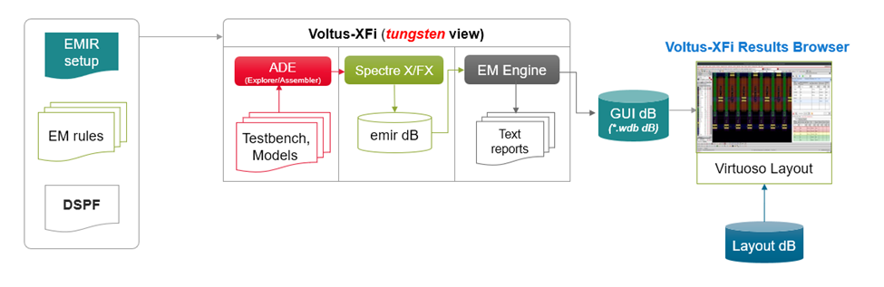

Walkthrough of EM-IR Signoff Using Voltus-XFi
Let’s walk through a practical scenario where a custom analog design undergoes transistor-level EM-IR (Electromigration and IR-drop) signoff using Voltus-XFi. This example illustrates the complete flow from setup to analysis, highlighting how the tool simplifies and accelerates the process.
Step 1: Design Setup in Virtuoso ADE and Save the EM-IR Setup State
Create a maestro view, configure Spectre X, define corners, and save your EM-IR setup state in the ADE Explorer/Assembler environment.
Step 2: Launch Voltus-XFi and Configure Tungsten View
Create a tungsten view, define project settings, and auto-load EM rules and tech files. You define your power nets, signal nets, extraction settings, and simulation flow—all in one place. Use Quantus to generate a DSPF file. Validate it with the DSPF Linter to ensure simulation readiness.
Step 3: EM-IR Simulation with Spectre X
Link your testbench, choose between direct and iterated solver methods, choose the iterated solver, and apply +emirpreset=mx for balanced accuracy and performance. Generate the EM-IR Configuration file. Run simulations in GUI or batch mode, or distribute across multiple machines for faster turnaround.

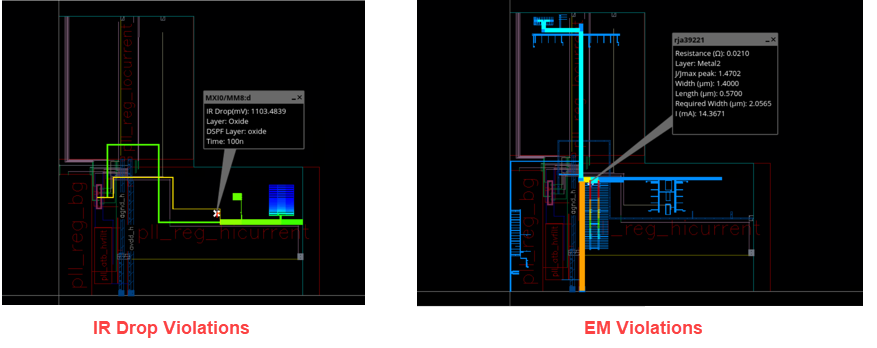

Step 4: Analyze EM-IR Results
Load results into the Voltus-XFi Results Browser, docked to the Virtuoso Layout window, to visualize IR drop and EM violations on the layout.
Analyze the Waveform Data results in Virtuoso Visualization and Analysis graph window more information, watch this video on Viewing Waveform Results in Voltus-XFi
Additionally, EM-IR reports are generated and made available in Voltus-XFi tungsten view.

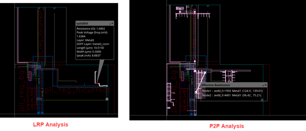

Use advanced IR drop debug techniques like Least Resistive Path (LRP) to trace weak power paths, and Point-to-Point (P2P) analysis to measure resistance between any two nodes, helping you quickly identify and fix layout issues.
