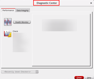

 Virtuoso suddenly slows down. Do you restart, call IT, or keep guessing? Before you do any of those, check its pulse.
Have you ever been in the middle of a Virtuoso session when a familiar command takes longer than expected, a design opens slowly, or the entire session stops responding? The immediate question is usually the same: Is the issue coming from Virtuoso, the design, the environment, or the surrounding system?
Instead of restarting the session or switching between multiple debugging utilities, open 'Diagnostic Center.' It brings performance and data-integrity checks into a single unified interface, helping you investigate the environment, library access, design data, and system resources. Start with 'Health Monitor' to check Virtuoso's pulse, determine whether the slowdown is related to the tool or to CPU, memory, or network activity, and collect the right debugging evidence to guide your next step.
Health Monitor: Start with the Pulse
Think of health monitor as the pulse monitor for Virtuoso. It continuously monitors Virtuoso and system health while you work, then signals when a performance issue arises, whether the source is Virtuoso or a non-Virtuoso resource such as CPU, memory, or network.
Its real-time status bar displays signals, the entry command, and a short message. The 'Advanced Form' provides CPU, memory, process, and network information, helping you distinguish tool behavior from a system-resource issue. If the slowdown persists, record callstacks to capture what Virtuoso is doing. If the session freezes, the user should terminate Virtuoso using the health monitor instead of the 'kill' command when Virtuoso is in a hang state.
Additional Checkers
Once the health monitor points you in the right direction, the diagnostic center's additional checkers provide targeted context through the following features:
  • Library: checks library information and access issues.
  • Design: checks recursion, statistics, memory usage, duplicate objects, database issues, constraints, and edit locks.
  • Environment: examines environment variables, graphics, remote desktop, licensing, system information, and data storage.
  • SKILL: provides profiling and replay for specialized debugging.
  • Data integrity: checks layout, constraints, and database integrity.
