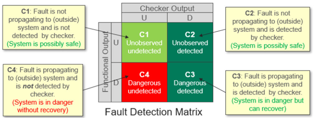

White check mark FuSa Results View with Fault Detection Matrix (FDM)
The FDM color-coded matrix classifies faults into:
  • DD (Dangerous Detected)
  • DU (Dangerous Undetected)
  • UD (Unobserved Detected)
  • UU (Unobserved Undetected)
