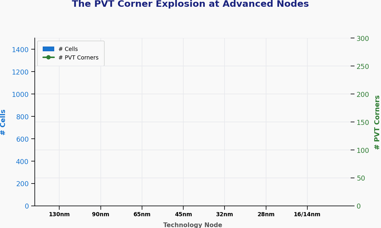

If you're working on standard-cell libraries at 28 nm or below, you already know the math isn't in your favor.
At the 130 nm node, a typical library had fewer than 100 cells and a handful of PVT corners. Fast-forward to 16/14 nm and beyond, libraries now contain 1,200+ cells across 200+ PVT corners.
Every new SoC tape-out demands broader coverage for design robustness, and the characterization workload has exploded.
The question is no longer whether you need multi-PVT characterization; it’s how fast you can adopt it.
The chart below shows how both cell count and PVT corner count have surged at advanced nodes:

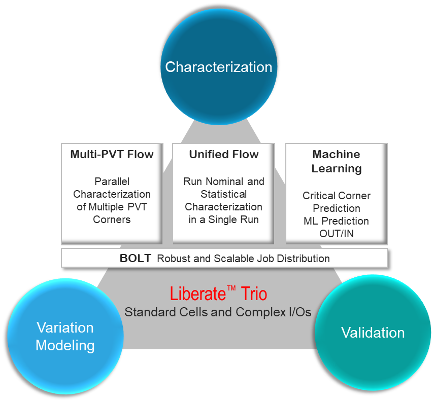

Liberate Trio is Cadence’s advanced library characterization platform designed for standard cells, multi‑bit cells, custom cells, and complex I/Os. It unifies three traditionally separate tasks into a single high‑performance flow:
Characterization
Process variation modeling (LVF)
Library validation
Key Capabilities
Simplified Flow
  • Run everything in a single session to characterize and model libraries across multiple PVT corners.
  • Minimum changes required to transition from a legacy single PVT flow to a multi-PVT (MPVT) flow.
Consistency
  • One consistent setup applied across all PVTs (same methodology, same configuration structure).
  • Uniform output structure for all generated LIBs across PVT corners, ensuring easier validation and integration.
Performance
  • Reuse preprocessing artifacts (e.g., vector database) across PVTs to avoid repeated work.
  • Reuse driver characterization results (e.g., driver waveform database) to accelerate repeated corners.
  • Better compute efficiency: maximize farm throughput via smart job distribution and parallel execution using Bolt.

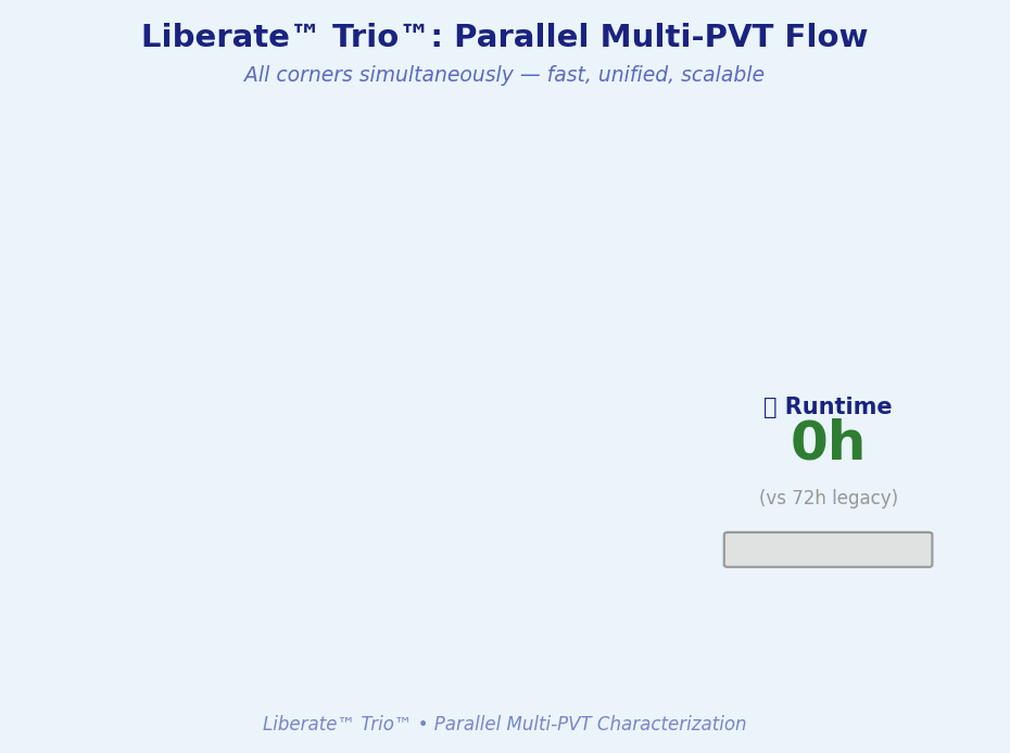

Liberate Trio eliminates traditional characterization bottlenecks by making the flow fast, scalable, and consistent across all PVTs.
  • Faster turnaround: Parallel multi‑PVT execution significantly reduces runtime
  • Consistent libraries: Single unified flow for nominal + LVF ensures better correlation
  • Scalable with Bolt: Efficient job distribution across farm/cloud enables high parallelism
  • Smarter resource usage: Reuse of data + optimized scheduling improves utilization
  • Full visibility: Real-time monitoring with quick failure recovery
  • Efficient recharacterization: Quickly rerun only impacted cells/corners instead of full characterization
