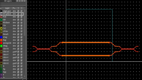

Picture yourself designing an MZI with two thermal phase shifters. In the physical layout view, you see the waveguides splitting and recombining light, with heaters placed strategically on the arms to induce phase shifts. The layout is rich in detail—curved waveguides, abutted components, and precise spatial relationships. This view showcases the physical beauty and complexity of your design.

Now, lets switch to the Place-Like Layout Schematic view. Instead of a linear, abstract representation, the schematic mirrors the physical layout. The Y-splitters, waveguide arms, and thermal phase shifters are placed in positions that reflect their actual physical arrangement. Connectivity is auto-routed, and symbols are generated to match the layout components. This visual fidelity makes the schematic intuitive, reducing debugging time and enhancing design clarity.

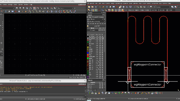

The Place-Like Layout feature operates within a layout-driven schematic flow, reversing the traditional schematic-driven layout paradigm. Here's how it unfolds:
  1. Enable Photonics Platform: Ensure the Virtuoso_Photonics_Platform environment variable is set and the appropriate license is active.
  2. Start in Layout EXL Workspace: Open the layout of your MZI cell view.
  3. Generate Schematic from Layout:
Select the layout instances.
Use the “Generate selected from layout” icon.
Drag to the schematic window and press F3 to open the Generate selected from layout
Choose Placement Mode: “Place-Like Layout”.
Place instances in the schematic according to the layout placement.
  Auto-Connect Waveguides: Abutted instances in the layout automatically connect in the schematic, preserving net integrity.
