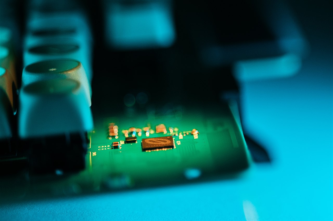

Norwegian semiconductor company ONiO has taken a different approach: instead of asking how long a battery can last, it is designing connected devices to use energy already available in their environment.
Reimagining IoT Without Batteries
ONiO was founded around a simple but demanding idea: make useful, connected products without assuming that a battery has to be there.
Its ONiO.zero platform can harvest ambient energy from sources such as radio-frequency signals, light, thermal gradients, and vibration. In suitable applications, that energy can replace the battery entirely.
The platform is designed to work with a broad range of energy sources rather than one specific harvesting technology. ONiO.zero integrates an on-chip RF energy harvester and supports photovoltaic, thermal, kinetic, and piezoelectric sources. It operates across a supply range from 250 mV to 3.0 V and can be powered by harvested energy, capacitors, supercapacitors, secondary cells, or conventional batteries. That gives developers room to choose the energy architecture that fits the product.
ONiO.zero brings computing, wireless connectivity, memory, security, and power management together in a highly integrated wireless microcontroller. The difficult part is making all those functions useful inside the tiny energy budgets that harvesting can provide.
Setting New Standards for Ultra-Low-Power Computing
Battery-free operation starts with a very small power budget.
Independent EEMBC ULPMark®-CoreMark® results provide a useful reference point. In the published ONiO entry, energy, fixed voltage is 178 at 3.0 V and energy, best voltage is 181, also at 3.0 V; the performance score is 124. Those are the benchmark scores. ONiO's separate 22 µW/MHz figure describes power while running CoreMark from non-volatile memory at 4.1 CoreMark/MHz.
The device uses a custom 16/32-bit RISC-V RV32IMC processor, designed in-house rather than licensed, and combines that processing capability with the ability to cold-start from less than 1 µW of available power and sleep at well below 1 µW. For energy-harvesting products, those states matter as much as headline compute efficiency: the device must wake, do useful work, communicate, and return to sleep without exhausting the energy that has been collected.

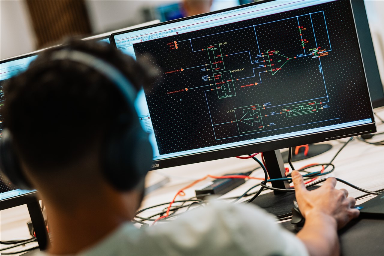

Reaching those power levels is a system-level design problem. Processing, radio, memory, security, analogue circuitry, and power management all must be optimized together, across both analogue and digital domains. An improvement in one part of the device is not enough if another part consumes the harvested energy first.
ONiO used a comprehensive Cadence design flow to manage that complexity: Cadence Virtuoso Studio for analogue and mixed-signal design, the Innovus Implementation System for digital implementation, Xcelium Simulator and Jasper Formal Verification for verification, Tempus Timing Signoff for timing closure, and the Pegasus Verification System for physical verification.
ONiO CTO Vemund Bakken says the company selected Cadence as its sole EDA partner because of the breadth and integration of the environment and flexible licensing. Having tools available on tap is mandatory for a company like ONiO, where almost every single tool Cadence offers are used during the design cycle. These include analog capture and simulation in Virtuoso, synthesis with Genus, timing closure with Tempus, and place and route using Innovus.
