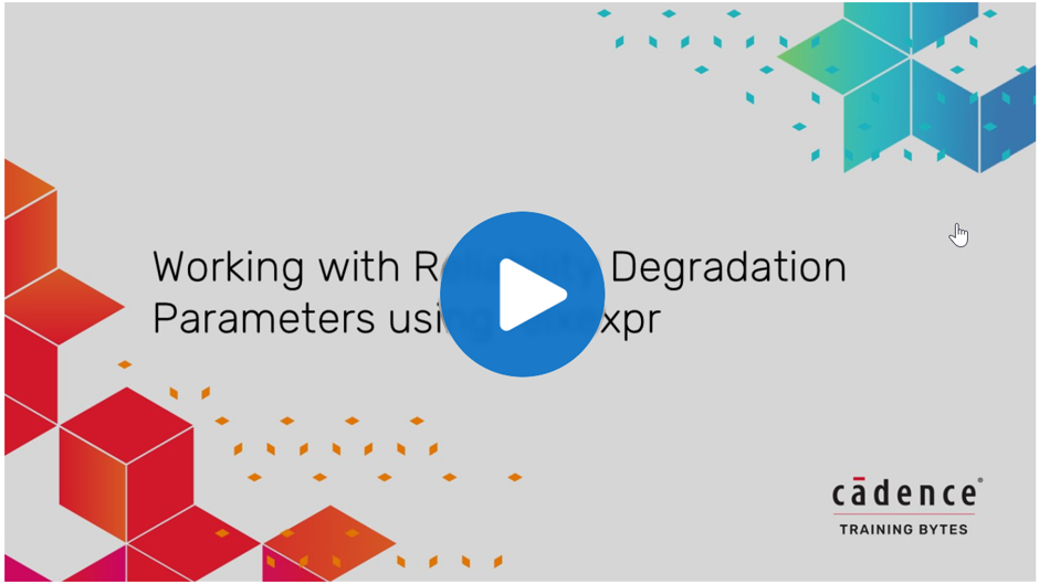

Watch and Learn: Demo Video on Reliability Degradation Parameters!
To understand more about reliability degradation parameters, you can watch a small training bye video which shows this in action.
Working with Reliability Degradation Parameters using relxexpr (Video)
