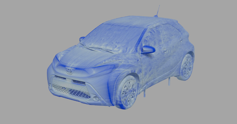

Benchmarking the Aygo X on Blackwell GPUs
This study evaluates a full-vehicle body refinement strategy using a mesh configuration based on clipped Voronoi diagrams designed to resolve external aerodynamic flow features. The configuration applies uniform refinement across the vehicle's complete external body and contains 178 million control volumes (MCVs).
The mesh configuration, along with the low dissipation of Fidelity Charles operators, enables simulation of fine-scale unsteady flow structures that influence external aerodynamics and aeroacoustic analysis. This approach enables a more detailed virtual wind tunnel analysis, offering accuracy, efficiency, and scalability in production-scale automotive CFD workloads.

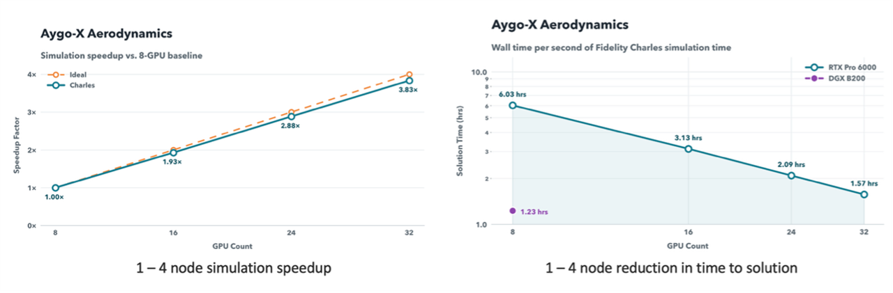

Preliminary results show strong scalability for high-fidelity aerodynamic simulation on Blackwell GPUs. For the Aygo X model, the graphs below show the simulation speedup and the decreasing wall time per second of simulation time with increasing GPU count.
Simulation results of the Aygo X external aerodynamics: (i) simulation speed up vs. GPU count on RTX Pro 6000 Blackwell Server Edition (left), (ii) wall time per second of simulation time vs. GPU count on RTX Pro 6000 Blackwell Server Edition and DGX B200 (right)
For the same Aygo X simulation, the right-hand graph shows that the eight-GPU B200 configuration reaches convergence about 5X faster than the RTX PRO 6000 Blackwell Server Edition. It also shows the difference in per-GPU performance: the RTX PRO 6000 requires 32 GPUs to approach the convergence time achieved by the B200 with only eight GPUs.

The results highlight the value of higher per-GPU performance for production-scale CFD. While the RTX PRO 6000 Blackwell Server Edition shows improved turnaround time as GPU count increases, the DGX B200 system achieves comparable convergence time with significantly fewer GPUs. This suggests that next-generation GPU architectures can help engineering teams reduce infrastructure requirements while increasing simulation throughput. For automotive workflows, this can translate into more design iterations, broader parametric studies, and larger high-fidelity datasets for future AI physics development.
