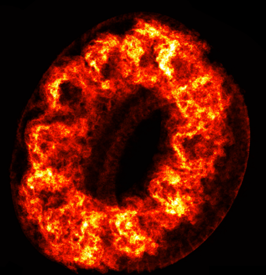

High-fidelity simulations of Solar Turbines' Taurus 60 SoLoNOx combustor were conducted in collaboration with Argonne National Laboratory to investigate the effects of exhaust gas recirculation (EGR) on combustion instabilities and emissions (Kabil et al., 2025). With Cadence's Fidelity Charles Solver and a flamelet progress variable (FPV) turbulent combustion model, the simulations achieved excellent accuracy by capturing detailed turbulent flow structures and combustion chemistry. These efforts were validated against experimental data, offering insights into the impact of EGR under varying conditions while ensuring scalability and efficiency.
Geometry of the Taurus 60 gas turbine combustor. (a) Full annular combustor (b) Double injector sector (Kabil et al., 2025)
Breakthrough Simulation Performance with NVIDIA Accelerated Computing
NVIDIA AI infrastructure played a critical role in the success of these simulations. The initial simulations were performed on NVIDIA GPU clusters at Argonne National Laboratory, with scalability tests demonstrating approximately 90% efficiency on 80 GPUs for a case involving roughly one million cells per GPU. This translated to a computational speedup of nearly two orders of magnitude compared to traditional CPU-based methods.
Building on this progress, advanced simulations of the large-scale model utilizing finer meshes were conducted on NVIDIA GB200 NVL72. These scalable, high-fidelity simulations achieved an impressive 94% parallel efficiency on 128 GPUs and sustained 75% efficiency when scaled up to 512 GPUs. Remarkably, this performance enables simulations of a full-360º gas turbine combustor, comprising over 1 billion cells, in just 14 hours, using 512 GPUs. To match this level of performance with CPUs alone would require the computational power of an entire data center.
