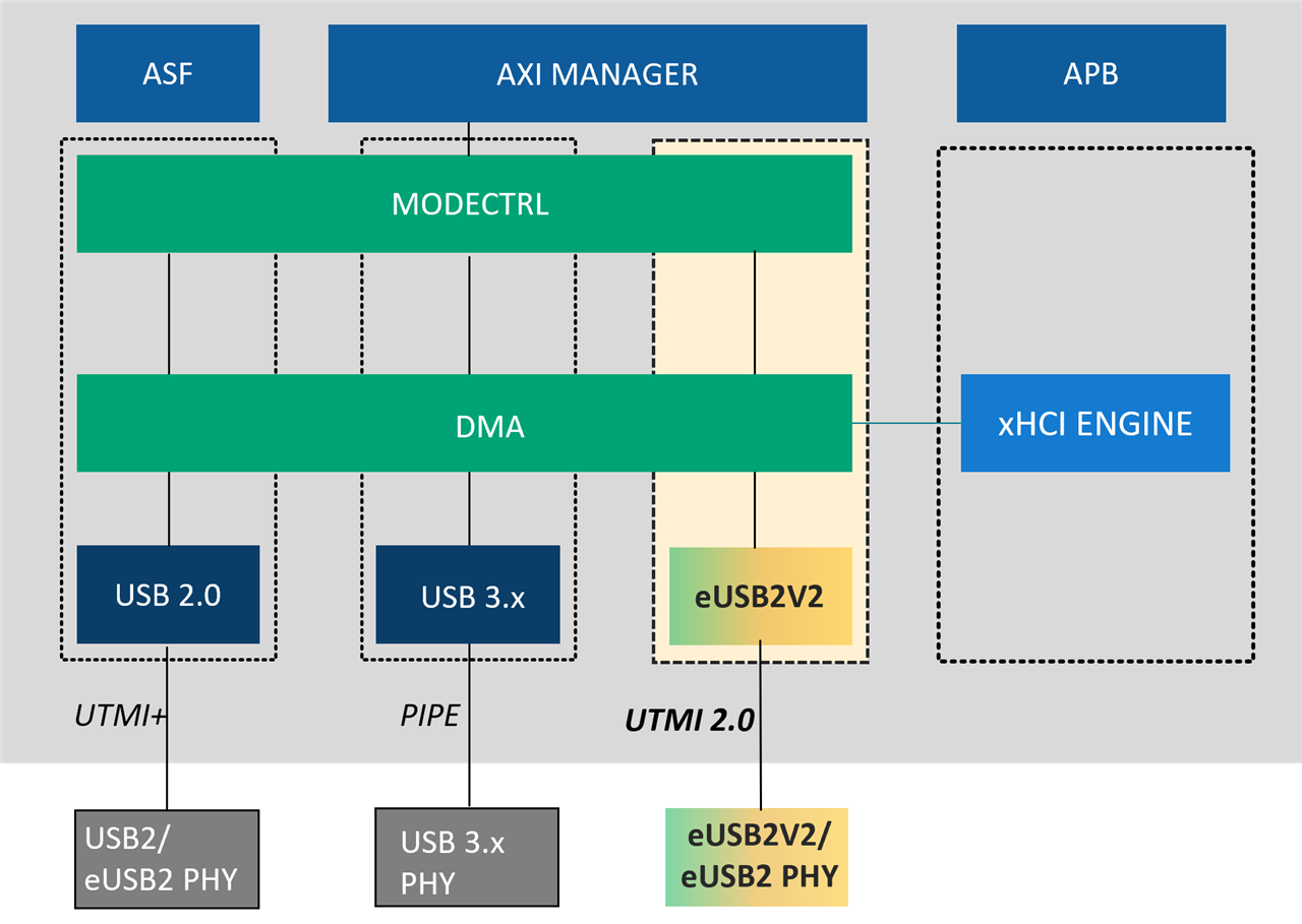

Figure 1 illustrates the eUSB2V2 controller architecture, combined with USB 3.x and USB 2.0 (eUSB2v1).
Figure 1. eUSB2V2 controller architecture

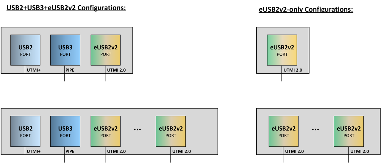

Whether you have existing multiple USB ports and want to add eUSB2V2 ports, or you're replacing a single USB 2.0 port, Cadence's eUSB2V2 controller provides the flexibility to integrate seamlessly. Figure 2 illustrates examples of controller configurations, including standalone options and combinations with USB 3.x and USB 2.0 (eUSB2). Additionally, Cadence's eUSB2V2 controller can be integrated with available USB solutions, including USB 3.x and USB 2.0. In other words, the eUSB2V2 standalone controller can be attached to an existing USB 3.x solution without requiring changes or introducing risk to the current design.
Figure 2. eUSB2V2 controller configurations

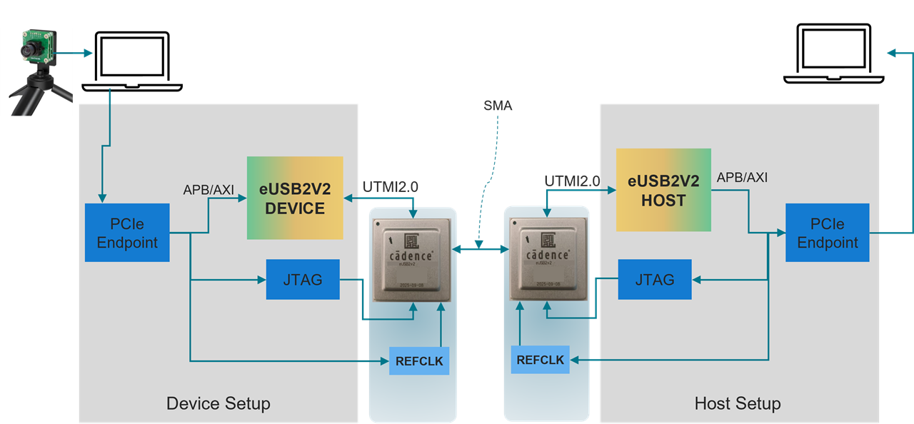

When it comes to high-speed connectivity, nothing builds trust like a real working system. The end-to-end demo setup (Figure 3) features 3nm eUSB2V2 PHY test chips for both host and device, paired with controllers implemented on FPGA boards.
A high-resolution camera streams max raw data in real time through PC/ATX boards to the FPGA system. On the host side, the FPGA board runs the host controller and connects to a PC/ATX board and monitor, which displays the live video feed captured by the camera. This seamless flow of data illustrates the power and efficiency of eUSB2V2 in a real-world scenario.
Figure 3. eUSB2V2 end-to-end demo setup

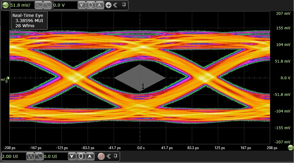

To validate link quality from the test chip, Cadence test engineers performed far-end eye diagram testing under 18.5dB ISI conditions and captured a clean eye diagram (see Figure 4). The 4.8Gbps signal demonstrates stable, error-free performance at high data rates, confirming the robustness and reliability of Cadence's end-to-end eUSB2V2 solution.
Figure 4. Eye diagram far-end testing with 18.5dB ISI
