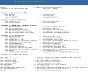

Getting Started with the June 2026 Kit
The setup remains intentionally simple. After downloading the release from the Cadence ASK portal, users can install and launch the environment with the following flow:
  • cd <your_work_area>
  • gtar -zxvf VTK_Jun_15_2026.tar.gz
  • cd VTK_Jun_15_2026/Voltus_Training_Kit
    # Edit environment_settings to set the PDF reader, for example: setenv PDF_READER evince
    # Source the environment and run make commands
    source environment_settings
You may find various common make commands in the Voltus Training Kit.
