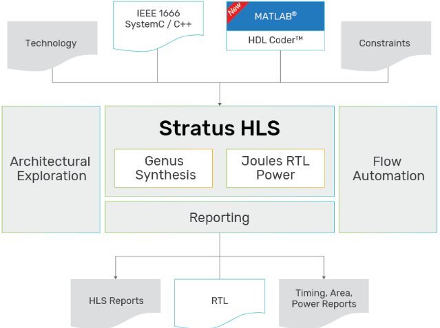

Traditional RTL design methodologies often fall short in the race to deliver faster, more efficient, and power-optimized hardware. They are time-consuming, error-prone, and rigid in architectural exploration. Stratus High-Level Synthesis (HLS) is a proprietary tool of Cadence, a transformative tool that empowers hardware designers to generate synthesizable Verilog RTL from SystemC, transaction-level SystemC, or C++ descriptions. Whether you're a design engineer, verification specialist, or system architect, this post will guide you through the core capabilities of Stratus HLS and how it streamlines, enables smarter, faster, and more optimized hardware development.
Why Stratus HLS?
Stratus HLS is designed to bridge the gap between algorithmic modeling and RTL implementation, delivering easier design re-use and superior PPA in less time. It allows designers to focus on functionality and architecture rather than managing low-level implementation details, and the capability to manage and automate the design process. Few real-world case-study statistics showed close to 70% improvement in area, 90% improvement in power, and 100X improvement in overall design time with the use of Stratus HLS-generated Verilog RTL compared with hand-coded Verilog RTL.
Stratus HLS offers numerous benefits to improve design workflow, such as:
  • Unified Verification: Use the same testbench across behavioral, RTL, and gate-level simulations.
  • Faster Time to RTL: Rapidly iterate through architectural options using synthesis directives and attributes and develop more optimal micro-architectures that deliver greater performance and consume less power.
  • Design Space Exploration: Evaluate tradeoffs in area, power, and performance with minimal code changes and enhance the overall design quality.
  • Integration with EDA Tools: Seamless handoff to Genus Solutions for running logic synthesis and Joules for performing power estimation and other third-party tools.

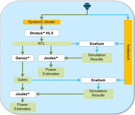

Stratus HLS transforms untimed SystemC/C++ model descriptions into optimized Verilog RTL through a multi-stage process as listed:
  1. Normalization – Parses and prepares the high-level code.
  2. Optimization – Builds a control/data flow graph (CDFG) and applies transformations.
  3. Scheduling – Maps operations to clock cycles based on constraints.
  4. Allocation – Binds operations to hardware resources and generates RTL

  • Tool Integrations: Stratus HLS seamlessly integrates with other Cadence and third-party tools, enabling a smooth and cohesive design flow from high-level synthesis to implementation. Some notable tool integrations that can be enabled are Xcelium for functional simulation, Genus Synthesis Solution for logic synthesis, and Joules for performing power estimations.
