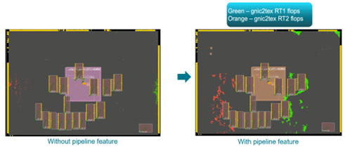

  • GigaPlace also introduces Advanced Pipeline Placement, which automatically collects pure F/F pipelines and balances stage spacing/point-to-point wirelengths; note. It eliminates skewed pipeline structures and produces smoother point-to-point wirelengths, yielding better data path symmetry and higher achievable frequencies.

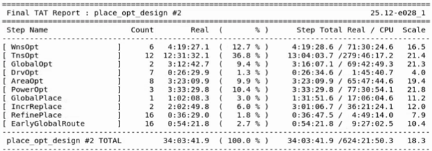

To reach the desired PPA, the Innovus Implementation System offers many options, including mega options that include new path compaction and more, as detailed below:
  • Mega options offer an easy/clear way to create a flow/recipe for much better PPA. Timing, power, and area effort can be improved at both LUI and CUI levels. Use the explicit knobs to set effort and ROI expectations:

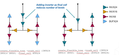

H‑Tree New Synthesis Features: More Cell Choices, Less Power
The latest Innovus Implementation System release introduces significant improvements to H-tree synthesis, focused on reducing power consumption and enhancing insertion delay in clock distribution networks. The new H-Tree features now support multiple trunk cells from the same cell family in the trunk section of the tree. These cells can have lower or equal drive strength compared to the original reference H-Tree, allowing the tool to create a more power-efficient trunk while maintaining timing integrity.
Similarly, the Innovus Implementation System now supports multiple options for final (leaf) cells, allowing designers to substitute the traditional buffer with an inverter when polarity constraints allow. This flexibility can reduce one tree level and improve overall insertion delay without compromising correctness.
Best practice guidance: use multiple trunk cells from the same family with a drive equal to or lower than the reference trunk; allow an inverter at the leaf when polarity permits to remove one level. Example commands:
create_flexible_tree –trunk_cell {INVX24 INVX16 INVX8} –final_cell BUFX24
create_flexible_tree –trunk_cell {INVX24 INVX16 INVX8} –final_cell {BUFX24 INVX24}

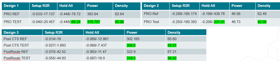

Post‑Route Optimization: Reimagined (New PRO)
New PRO features overhaul closure after routing by fixing the root causes of late-stage instability and then introducing a staged, timing-accurate optimization ladder. The legacy flow suffered from weak pre‑/post‑route correlation, coarse congestion/SI/topology estimation, a limited trackOpt transform set, and almost no router‑optimizer interplay, causing PPA loss, timing “jumps,” and ecoRoute DRC churn that stretched convergence.
The new PRO addresses this by moving from soft wires and global routes with dRoute-level accuracy (eDR) to hard wires (final detailed routes), letting the optimizer try bigger, smarter changes while seeing near-final parasitics. Concretely, it runs through four stages:
  • Init, reclaims inefficient buffer chains and poor layer assignments to relieve congestion and set a better topology
  • Soft, uses eDR (detail‑route‑level) global routes with SI‑based timing to apply large, non‑legal transforms safely
  • Medium, narrows to moderate transforms
  • Hard/ECO, finishes with legal buffering/resizing only
This reduces post-route timing jumps, ecoRoute DRC churn, and improves pre/post correlation.

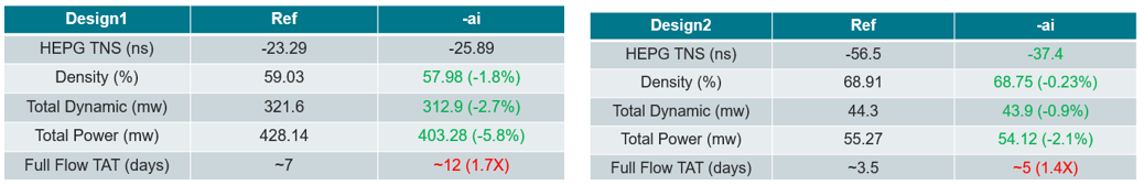

On recent customer designs (25.12), -ai runs demonstrated reduced density and total/dynamic power at the cost of longer exploratory TAT, which typically shrinks as recipes stabilize.
Design 1 density decreased by 1.8%, dynamic power improved by 2.7%, while total power declined by 5.8%, and TAT improved approximately 1.7 times. Similarly, Design 2 density decreased by 0.23%, dynamic power increased by 0.9%, total power decreased by 2.1%, and TAT improved about 1.4 times (exploration overhead typically shrinks as recipes stabilize).
