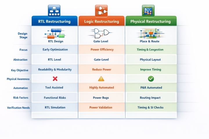

In the fast-evolving world of digital design, engineers are constantly challenged to deliver chips and systems that are not only functional but also optimized for power, performance, and area (PPA). Techniques such as RTL Restructuring, Logic Restructuring, and Physical Restructuring are game changers in this pursuit. Here’s why every digital design engineer should understand and leverage these methods.
RTL Restructuring: Design Clarity and Early Optimization
Register Transfer Level (RTL) restructuring takes place earlier in the design flow, focusing on the logical hierarchy and structure of RTL code. The goal of RTL Restructuring is to improve PPA, design readability, and synthesis efficiency.
Why Is RTL Restructuring Important?
  • Early impact: RTL restructuring empowers RTL designers to optimize designs before synthesis, enabling accurate early estimates for Power, Performance, Area, and Congestion (PPAC).
  • Design readability: By grouping, ungrouping, moving, or adding modules, designers can make their designs easier to analyze, debug, and maintain.
  • Accelerated development: Automated RTL restructuring for PPA can save significant time on large projects, minimizing backend iterations and improving time-to-market.
  • Quality of Results (QoR): Improved modularity and clarity result in better synthesis outcomes and more predictable implementation.
What Should Front-End RTL Designers Know?
Manual RTL restructuring requires deep design skills and careful attention to maintaining functional equivalence. Automated tools, such as those found in Joules RTL Design Studio, can streamline the process, but engineers must still validate changes and ensure that design intent is preserved.
Logic Restructuring: Optimization at the Gate Level
Logic restructuring is a gate-level optimization technique that focuses on reducing dynamic power consumption. By reorganizing logic cones, the blocks of combinational logic that drive or are driven by specific points such as registers or I/O ports, engineers can minimize unnecessary switching activity. This results in less wasted energy and more efficient designs.
Why Is Logic Restructuring Important?
  • Tool-driven efficiency: Modern synthesis tools can easily automate logic restructuring, making it accessible even for large, complex designs.
  • Verification is key: Gate-level modifications can introduce subtle bugs. Thorough verification is essential to ensure that optimization doesn’t compromise functional accuracy.
What Should Synthesis Engineers Know?
Logic restructuring is most effective when paired with power-aware tools and robust verification strategies. It’s not just about saving power, it’s about doing so reliably and consistently.
Physical Restructuring: Closing the Gap Between Logic and Silicon
Physical restructuring focuses on optimizing the physical implementation of a design - placement, routing, and connectivity - while preserving functional correctness. Unlike RTL or logic restructuring, this stage operates with detailed physical awareness, making it a powerful lever for meeting aggressive timing, power, and area goals late in the design cycle.
As designs scale in complexity and advanced nodes introduce tighter margins, physical restructuring becomes essential for achieving predictable and high-quality results.
Why Is Physical Restructuring Important?
  • Timing closure under real constraints: Physical restructuring enables engineers to address timing violations that cannot be solved through synthesis alone. By restructuring logic based on placement, routing congestion, and interconnect delays, designers can shorten critical paths and improve setup and hold margins where it matters most.
  • Interconnect-dominated optimization: At advanced nodes, wire delays often dominate gate delays. Physical restructuring helps by rebalancing logic, breaking long combinational paths, and repositioning logic closer to registers or endpoints, thereby reducing wirelength, latency, and variability.
  • Improved power and area efficiency: Restructuring at the physical level can reduce unnecessary buffering, eliminate redundant logic, and enhance local clustering. This results in lower dynamic and leakage power while maintaining, or even reducing, overall area.
  • Reduced ECO and iteration cycles: Instead of repeated manual ECOs, automated physical restructuring enables tools to make intelligent, localized changes that respect physical constraints. This significantly shortens the timing closure loop and improves productivity.
What Should Back-End Engineers Know?
Physical restructuring is most effective when it is:
  • Timing and congestion-aware, not purely logical
  • Incremental, preserving most of the existing placement and routing
  • Closely coupled with signoff analysis, including SI and power
Modern implementation tools can automate physical restructuring, but engineers must carefully review changes, validate equivalence, and ensure that optimizations do not negatively impact routability or downstream signoff.
Ultimately, physical restructuring bridges the gap between idealized logic optimization and real silicon behavior, making it a critical technique for achieving robust, manufacturable designs.
Conclusion
Restructuring is not a single technique that spans the entire design flow. When applied at the right stage — RTL, logic, or physical — it helps meet aggressive PPA goals with fewer iterations and greater confidence.
