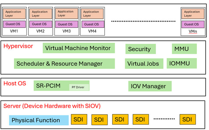

The SIOV architecture introduces a software-centric approach to I/O virtualization, designed for hyperscale cloud environments. At its core, the Host OS manages resource allocation and abstracts hardware complexities from virtual interfaces. The hypervisor sits atop, acting as a Virtual Machine Monitor (VMM) and I/O Manager, dynamically mapping resources and orchestrating the creation and lifecycle of lightweight Scalable Device Interfaces (SDIs). Guest OSs within Virtual Machines (VMs) then interact with these virtualized interfaces, enabling multiple Application Layers to efficiently share physical hardware resources with enhanced isolation and scalability.
