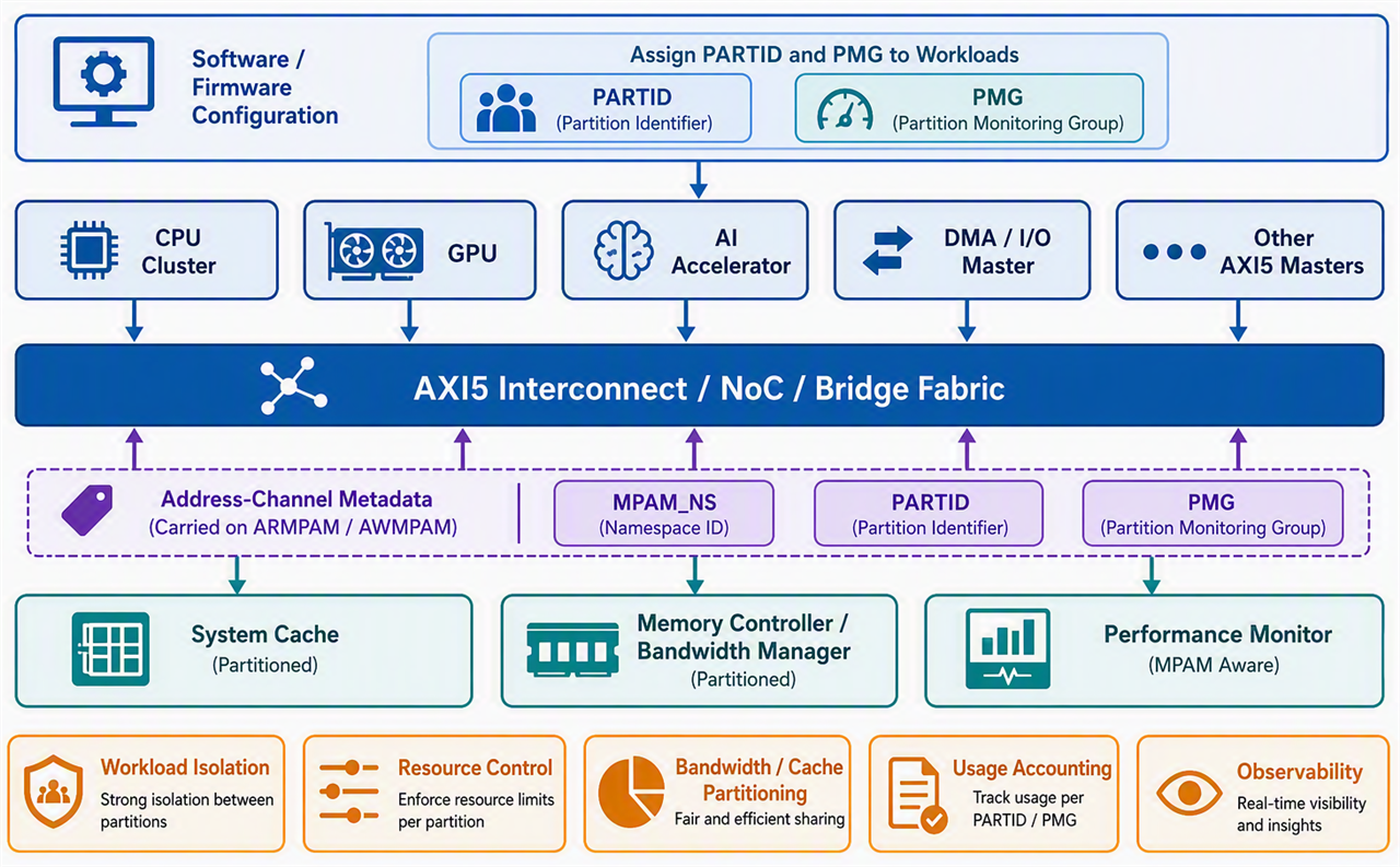

AXI5 MPAM Protocol Architecture
MPAM is defined as an optional AMBA 5 feature. Support is controlled through the MPAM_Support interface property. When MPAM is enabled, read and write address requests carry MPAM information using ARMPAM and AWMPAM. When the feature is not supported, these signals are not present on the interface.
The MPAM information contains three logical fields:
MPAM_NS: Security Context
MPAM_NS provides the security indicator associated with the transaction.
PARTID: Partition Identifier
PARTID identifies the resource partition associated with the transaction. Interconnects, caches, and memory controllers can use the identifier when applying controls to shared resources such as cache capacity or memory bandwidth.
PMG: Performance Monitoring Group
PMG identifies the context used for performance accounting, traffic monitoring, profiling, and debug. It enables resource usage to be attributed to the appropriate workload or monitoring group without changing the partition assignment.

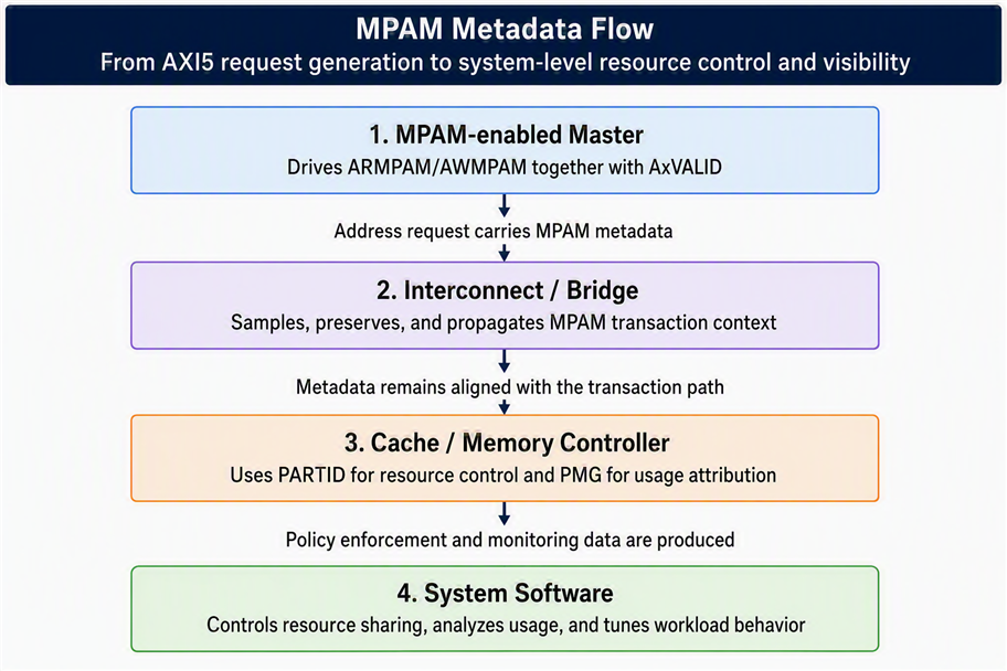

How MPAM Information Flows Through the System
MPAM information travels as metadata alongside the transaction address. An MPAM-enabled master drives the appropriate value on a read or write address request, and downstream components sample the value with the corresponding valid address transfer. The interconnect can propagate the metadata toward caches, bridges, and memory controllers that implement partitioning or monitoring functions.
The values generated by a master are implementation-defined and are typically selected through software, firmware, or system configuration. MPAM identifiers have global scope, so an interconnect is not required to remap them or make them unique for each master. Where system components use different MPAM configurations, the implementation must define how widths, defaults, and unsupported fields are handled.

Practical System Use Cases
Cloud and Virtualized Workload Isolation
Hypervisors and system software can associate virtual machines, containers, or applications with distinct resource partitions and monitoring groups. This helps prevent one workload from monopolizing shared cache capacity or memory bandwidth, while enabling usage to be profiled or accounted for independently.
AI Accelerators and Heterogeneous SoCs
CPUs, GPUs, AI accelerators, and DMA engines frequently share DRAM bandwidth. Assigning different PARTID values enables the memory system to distinguish traffic classes for resource control, while PMG values provide visibility into the bandwidth consumed by each monitored workload.
Monitoring, Debug, and Accounting
Because monitoring information accompanies the transaction, memory-system usage can be attributed at multiple points in the hierarchy. This supports workload profiling, bottleneck analysis, latency debug, resource accounting, and placement optimization.
Automotive and Real-Time Systems
In systems where predictable latency matters more than peak throughput, MPAM information can distinguish safety-critical or latency-sensitive traffic from background activity. Resource controls can then limit interference, while monitoring provides visibility into actual consumption.
