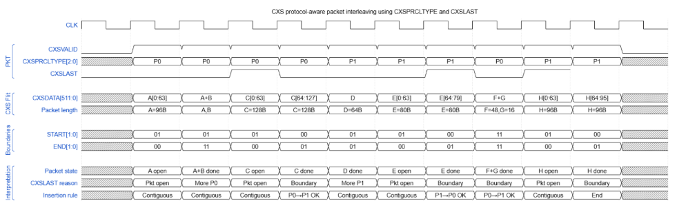

Legal Insertion Boundaries with CXSLAST
CXSLAST is an optional flit-level indication that flits from another source or stream can be inserted after the current cycle. It is best understood as an insertion-permission boundary, not simply an end-of-packet indication, because CXS can require multiple complete packets to remain contiguous as a group.
CXSLAST must be de-asserted when the following packet must remain after the current packet, or when a packet has started but has not ended in the current flit. When CXSLAST is low, the receiver expects additional traffic for the protected sequence ,and another source must not be inserted. When the signal is not implemented, it is generally assumed asserted, except while a packet is incomplete in the current flit.
The waveform illustrates how protocol streams share the CXS link while CXSLAST marks where a stream transition is permitted. A transition must not interrupt an incomplete packet or a packet group that is required to remain contiguous.
