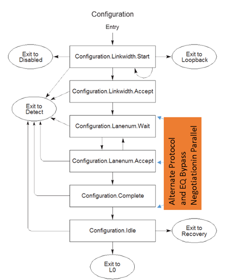

While the PCIe link is being trained, the devices are allowed to negotiate an alternate protocol during three of the Link Training Status State Machine (LTSSM) states:
  • Configuration.Lanenum.Wait: Proposes lane numbers for each lane of the link.
  • Configuration.Lanenum.Accept: Confirms the lane number of each lane of the link.
  • Configuration.Complete: Makes sure that the link configuration is correct.
This involves exchanging modified training sets (TS1/TS2) using 8b/10b encoding mechanism, with support for other encodings like 128b/130b.
Figure 1. Configuration LTSSM states transition diagram

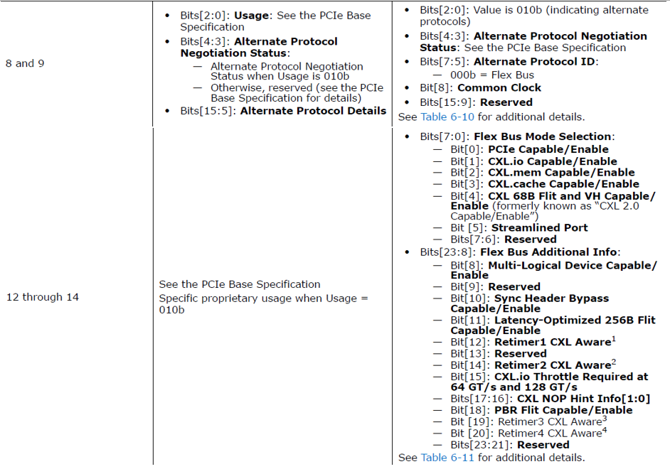

The modified training sets are modified versions of the standard PCIe training set, containing APN-specific data from symbols 8 to 14, with fields modified TS info 1 (symbols 8 - 9) and Info 2 (symbols 12 - 14). If the modified training sets are not supported, the link will operate in PCIe mode. The meanings of the symbols are determined by the alternate protocol being negotiated.
Figure 2. APN-specific symbol meanings

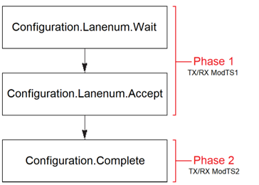

Flex Bus.CXL Mode APN is divided into two main phases: phase 1 and phase 2. LTSSM state transitions still follow PCIe rules.
Figure 3. Phase 1 and Phase 2 overview

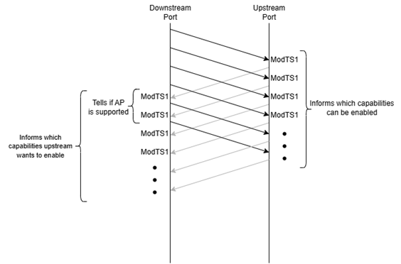

Phase 1
Happens during Configuration.Lanenum.Wait and Configuration.Lanenum.Accept.
Figure 4. ModTS1 exchange flow in phase 1

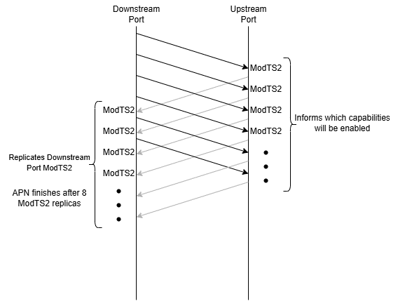

Phase 2
Happens during Configuration.Complete.
Figure 5. ModTS2 exchange flow in phase 2
If the downstream port receives a different combination of the Flex Bus bits than what it transmitted, LTSSM returns to detect state. And if the upstream port receives any combination that is not a subset of what is advertised in phase 1, the behavior is undefined.
After the Negotiation
As soon as the eight modified TS2s with flex bus capabilities replicas are received by the downstream port, the APN is finished successfully, and the upper layers are allowed to be informed of the results of the exchange. However, the CXL features are only allowed to be enabled after the LTSSM goes to L0 at a speed of at least 8 GT/s.
