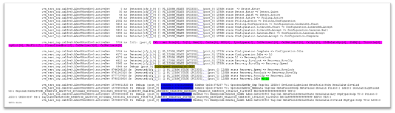

The snippet below shows a fully functional CXL4 Type3 configured VIP operating at Gen7 speed with M2S packets being transmitted:

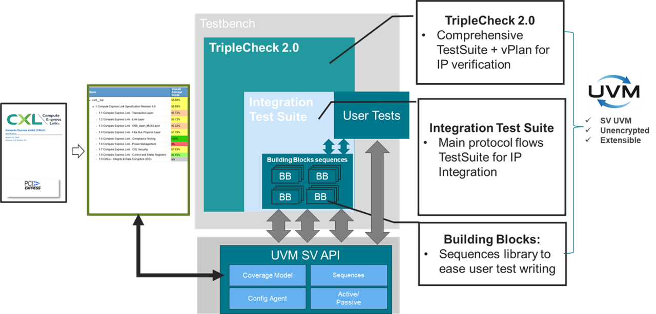

CXL 4.0 Triplecheck
In addition, Cadence Verification IP offers the TripleCheck solution, which combines an extensive compliance test suite, a comprehensive coverage model, and a structured verification plan with clear traceability to the CXL specification. This enables fast, efficient, and compliance‑oriented verification. CXL TripleCheck support spans CXL 4.0, CXL 3.2/3.1/3.0, and CXL 2.0 specifications, and is available for both CXL Host and CXL Device DUTs. The test suite includes comprehensive compliance test cases with coverage directly annotated to the CXL specification, simplifying standards compliance and accelerating interoperability readiness.
