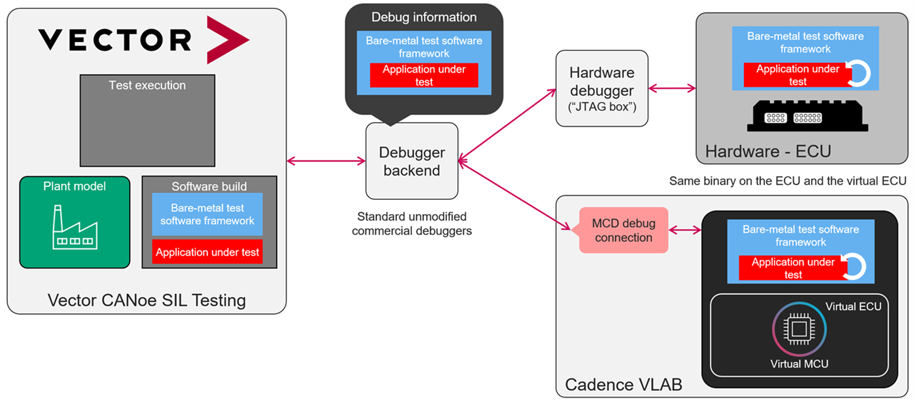

The first demo demonstrated software testing using the Vector SIL Adapter for software-in-the-loop (SIL) testing. The SIL Adapter runs the software under test on hardware (or virtual hardware) without requiring an operating system on the target or a network connection to communicate with the target. Test control and test data are provided to the target over a debugger connection.
The exact same setup works on hardware boards and a VLAB virtual platform. Both setups, physical and virtual, run the same binary. Both setups use the same debugger backends (Lauterbach and Tasking) to communicate with the targets. From the perspective of the CANoe tool, the virtual and physical hardware look identical. The difference is hidden in the debugger layer, which uses either a physical debug probe or the MCD protocol to access the target system.

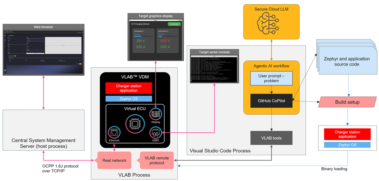

The second demo showed agentic AI analyzing and fixing a software problem autonomously. The VLAB virtual ECU runs a charger-station demo from the Zephyr project, which requires a network connection to a management system. However, when the target system boots, networking fails to initialize, and the software does not work.
The AI agent accesses VLAB through the Visual Studio Code VLAB tools, investigating the problem from several angles. It examines the target system's serial output, the target system's hardware hierarchy, and the source code of the software. The issue, a misconfiguration in the device tree, is resolved, and the resulting changes are rebuilt and retested.

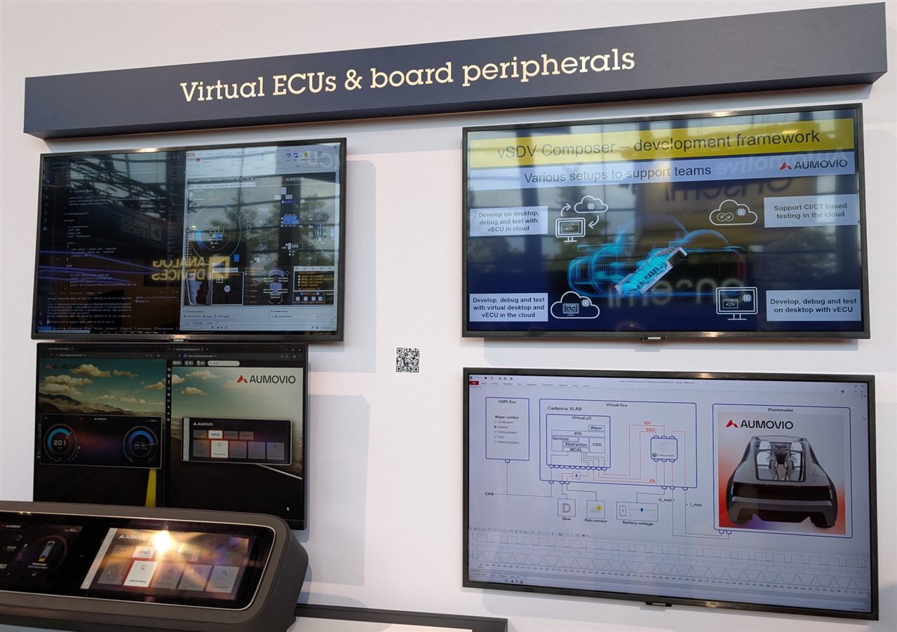

AUMOVIO Functional Twins: V-ECU with VLAB
AUMOVIO showed a very different type of demo with VLAB. In this case, a VLAB model of an MCU was integrated into an ECU-level simulation that also included a model of an electronically resettable fuse. The ECU model, in turn, was integrated into a system-level model that included some (simulated) electrical components.
The AUMOVIO demo setup – the simulation is shown on the right. It can be controlled from the touch-screen setup on the left (over a network bridge between the real world and the simulation).
The software on the ECU controls a windshield wiper. As the user selects different modes, the animation on the display on the right shows the wiper's behavior. It is also possible to simulate an overload of the electric motor, at which point the electronic fuse would trigger and protect the system.
The demo provides a good example of how a virtual ECU includes models of digital components, analog components, and the external world. Such a virtual ECU allows software to be tested in both nominal and exceptional situations.
