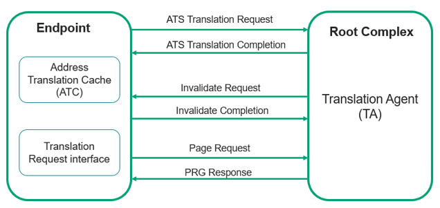

 Here is a diagram illustrating the interaction flow of Address Translation Services (ATS) in PCI Express:
Translation Request /Completion exchange
Address translation and caching are performed with the help of Memory Request transmitted from ATC to TA. Upon reception of the Translation Request, TA determines whether the translation can be provided to the function and indicates the success or failure of the request by generating a translation completion with the right response status.
Invalidate Request/Completion exchange
When a translation changes, the TA sends an Invalidation Request, so the ATC stays in sync with the ATPT. This request is a MsgD transaction that tells the ATC to remove specific address-range entries.
The Invalidate Completion message includes tags from the original request, so the TA can identify which function finished the invalidate operation.
Page Request/PRG Response message exchange
Page Request helps a PCIe endpoint (like a storage device) to request a page in a specific virtual memory address by transmitting a Msg TLP to RC. To notify a Function that the page request(s) associated with the corresponding PRG has (have) been satisfied with a PRG Response Message is a PCIe Message Request that is Routed by ID back to the requesting Function.

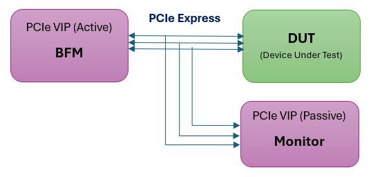

Cadence PCIe VIP verification test suite is built to solve challenges like the ones described above, by delivering a verification solution in terms of test cases and coverage model. It provides a golden reference that can fully verify any specification defined feature by applying randomization and cross feature verification. Our test suite includes self-checks or protocol checks, error injections, checker evaluation, callback verification, user configurable parameters and coverage model to make sure the feature is thoroughly verified. Cadence test suite eliminates the verification gap, and customers can effectively validate their design by using the provided test suite.
PCIe Express VIP Verification testbench architecture
