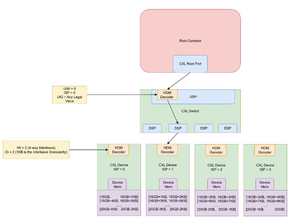

An Example of CXL Memory Interleaving and HDM Decoder
The following illustrates a simple memory fan-out topology with four memory devices behind a CXL switch. HDM decoder in each device, as well as the upstream switch port, is configured to decode the HPA range 16 GB to 20 GB, at 1-KB granularity. The leftmost device receives 1-KB ranges starting with HPAs 16 GB, 16 GB + 4 KB, 16 GB + 8 KB, …, 20 GB – 4 KB (every 4th Chunk). The root complex does not participate in the interleaving process.
Key Concepts Explanation
Interleave Way (IW): The number of memory units involved in a memory interleaving scheme. In CXL, an interleave set may contain either 1, 2, 3, 4, 6, 8, 12, or 16 CXL devices. 1-way interleave is equivalent to no interleaving.
Interleave Granularity (IG): Each device in an interleave set decodes a specific number of consecutive bytes, referred to as chunk, in HPA space. The size of the chunk is known as an interleave granularity. The starting address of each chunk is a multiple of IG.
Target: The HDM decoders in the CXL host bridge are responsible for looking up the incoming HPA in a CXL.mem transaction and forwarding the HPA to the appropriate root port target. The HDM decoders in the CXL upstream switch port are responsible for looking up the incoming HPA in a CXL.mem transaction and forwarding the HPA to the appropriate downstream switch port target.
Interleave Set Position (ISP): The position of this component in the interleave set formed when all HDM decode stages that are upstream of this port are considered. Expressed as a 0-based quantity.
The above parameters are configurable in CXL HDM decoder capability structure.

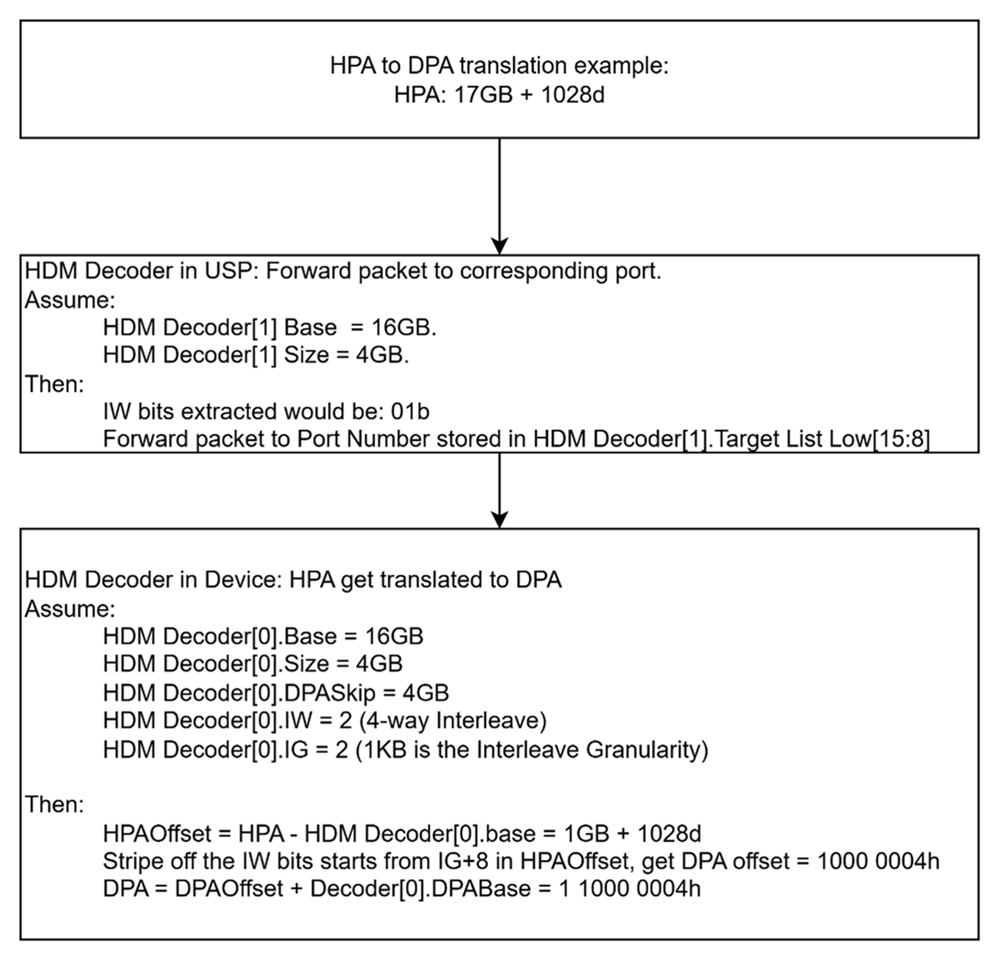

An Example of HPA to DPA Translation
Let’s use the above topology as an example and perform one HPA to DPA translation on one CXL.mem TL packet.

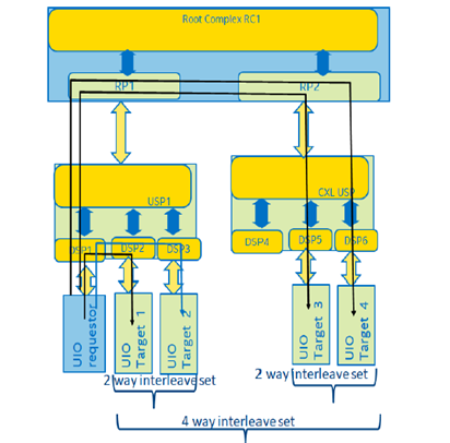

UIO Direct P2P to HDM
CXL.mem devices that can complete UIO requests targeting their HDM advertise the capability via the UIO-capable bit in the CXL HDM decoder capability register.
A UIO address is considered valid if at least one HDM decoder instance is capable of correctly processing the associated UIO transaction. This means the address must be a translated address, and the entire range of the UIO packet must fall within the bounds defined by the decoder and not crossing interleave boundary. A completer abort would be returned if there’s not a full match.
Further details on the matching rules and conditions can be found in section 9.16.1.1 and 9.16.1.2.
