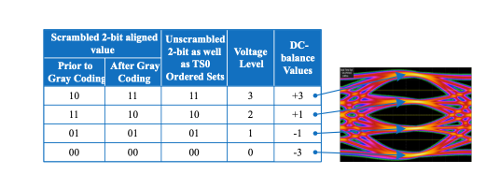

 Now, achieving this over existing meant using PAM-4 (Pulse Amplitude Modulation with four levels) signaling instead of traditional NRZ (Non-Return to Zero).
 To give you an idea about PAM-4, PAM-4 allows more bits per clock (2 bits instead of 1) but at the cost of:
  • Reduced noise margin
  • Higher bit error rate (BER)
  • Increased sensitivity to signal degradation
Figure: PAM4 signaling at UI level: Voltage levels, 2-bit encoding, and their corresponding DC balance values

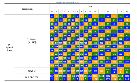

The FEC is a 3-way interleaved ECC, with each ECC code capable of correcting a single byte error. The interleaving is done
so that a burst error of up to 16 bits in any lane does not impact more than a byte in each interleaved ECC code word.
Each of the interleaved ECC has a different color. Thus, all blue colored bytes [e.g., 0, 3, 6, 9,…, 231, 234, DLP1, DLP4, CRC1, CRC4, and CRC7] are part of ECC Group 0 and are covered by the two blue colored ECC0[0] and ECC0[1] bytes (which are placed in the last symbol of the flit in lanes 12 and 15 respectively).
