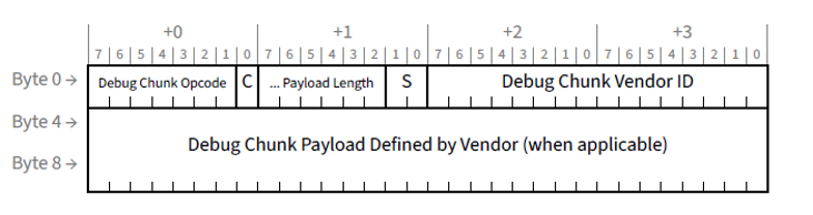

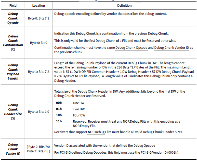

NOP Debug Flit Layout and Details of Fields
A single debug flit can contain multiple chunks, and chunks from different vendors may coexist within the same flit. Unused space is filled using empty debug chunks.
 Figure 1: NOP.Debug flit debug chunk
Figure 2: NOP.Debug flit debug chunk fields
