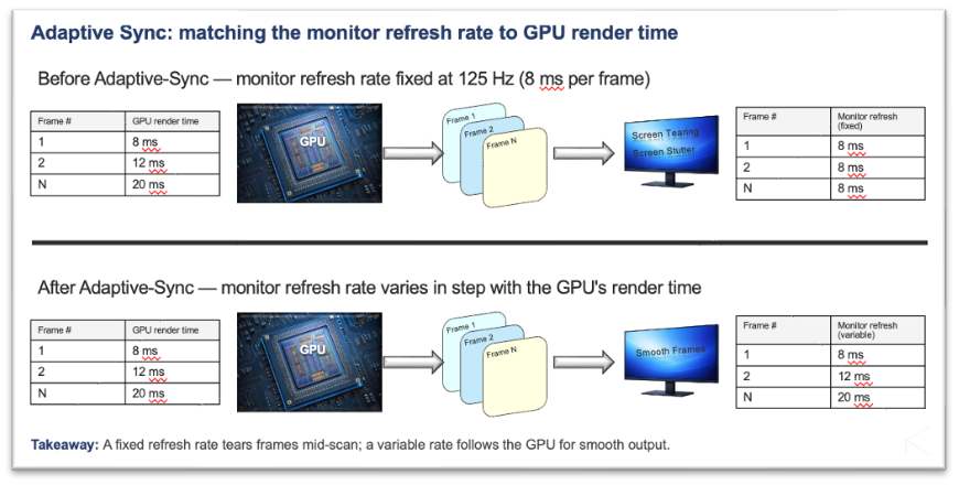

Fixed Refresh Rate vs Variable Refresh Rate (Adaptive-Sync)
Let's assume the monitor is configured for its maximum refresh rate of 125 Hz, which makes its refresh period set at 8 ms. If the GPU renders frames at intervals of 8 ms, 12 ms, and 20 ms, the monitor continues to refresh every 8 ms, regardless of when the GPU makes each frame available. This creates a mismatch between the GPU and monitor, which produces undesirable visual artifacts.
With Adaptive-Sync, the source can dynamically vary the frame interval based on the application, allowing the display's refresh rate timing to more closely track the GPU's output. For example, an 8 ms frame interval corresponds to a 125 Hz refresh rate, a 12 ms interval corresponds to approximately 83.3 Hz, and a 20 ms interval corresponds to a 50 Hz refresh rate. Synchronizing the GPU and display reduces artifacts while improving the overall experience.
The link rate and lane count do not need to change. See Figure 1 for a comparison of the GPU-to-display timing relationship before and after Adaptive-Sync.
Figure 1: Adaptive-Sync aligns the display refresh interval with the GPU’s frame interval

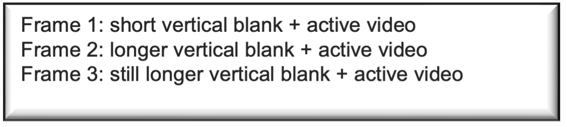

What Changes with Adaptive-Sync?
Under Adaptive-Sync, the duration between frames may change. The active video resolution can remain the same while the vertical blanking interval is shortened or extended.
Figure 2: Adaptive-Sync varies frame duration by adjusting the vertical blanking interval
Because the actual frame duration is now variable, certain fixed MSA timing parameters can no longer be relied on for the frame's timing and reconstruction.
Before Adaptive-Sync can be used, the DPRX must advertise support for ignoring MSA timing parameters during the discovery phase before link training. Once link training is complete, the DPTX can enable this functionality by setting the MSA_TIMING_PAR_IGNORE_EN bit (bit 7) in DisplayPort Configuration Data (DPCD) address 00107h. After this bit is enabled, the DPRX ignores the applicable MSA timing parameters as defined in the DisplayPort specification. The Adaptive-Sync SDP communicates the information needed to coordinate variable frame timing. The DPRX uses this information, together with the transmitted video stream and MSA, to control its refresh timing.
