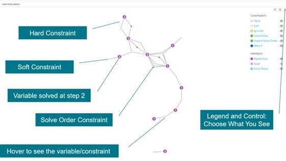

Fig. 1 Partition Graph of Constraint Randomization
The graphical representation of the randomization partition graphic makes it easier for engineers to understand the type of constraints and how variables are resolved. With the information, engineers will have a hint to understand why certain values of a variable are not properly generated.

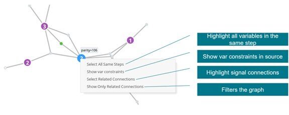

Fig. 2 Actions in the Partition Graph
In addition to the graphical view, engineers can easily link to the source code to review it to fix any issues.

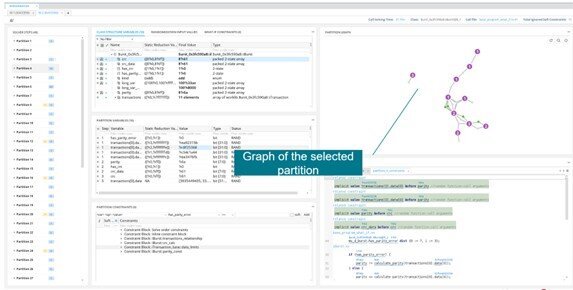

Fig. 3 Integrated Debug Environment with Partition Graph

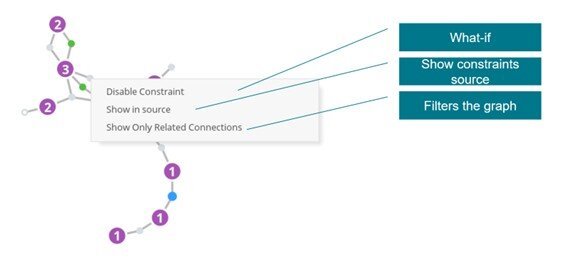

Verisium Debug also provides the so-called "What-if" capabilities, which allow engineers to quickly turn off a selected constraint to determine if it is not properly given without actually changing the source code, recompiling, and re-running the design for simulation. The turnaround time for the engineers to get the result from the change has become so fast.
Fig. 4: What-If Analysis on Partition Graph
