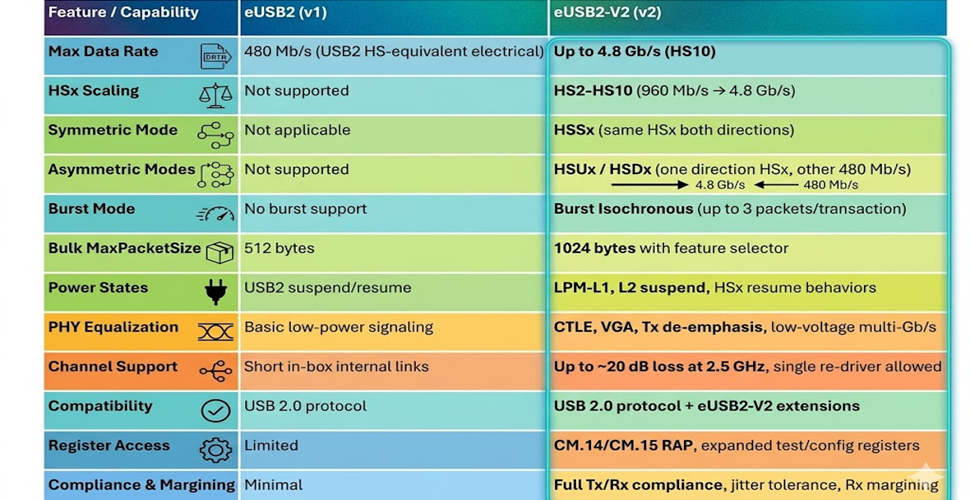

To set the stage, here’s a quick benchmark comparing eUSB2 v1 and eUSB2‑V2, highlighting just how significant this upgrade really is.

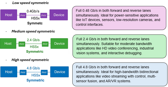

  • HSSx (Symmetric): Both upstream (device → host) and downstream (host → device) operate at the same HSx multiplier.
    Example: HSS10 = 4.8 Gb/s in both directions simultaneously.

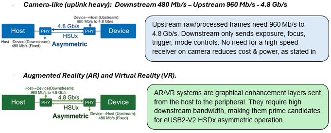

  • HSUx (Asymmetric Upstream): Upstream runs at an HSx speed (up to 4.8 Gb/s), while downstream remains fixed at 480 Mb/s.
    Example: HSU10 = 4.8 Gb/s upstream + 480 Mb/s downstream.

This asymmetric capability is not only unique but strategically significant. Many embedded peripherals—such as cameras—generate large upstream data flows (e.g., image streams) but need only modest downstream control bandwidth. In such cases, the SoC can eliminate the need for a high‑speed receiver on the peripheral side, reducing power, die area, and bill‑of‑materials cost. The specification explicitly states that asymmetric operation reduces peripheral complexity by avoiding the need for a gigabit‑class receiver.
Symmetric Speed Examples (Both Directions Matched)
Asymmetric Speed Examples (Directional Optimization)
