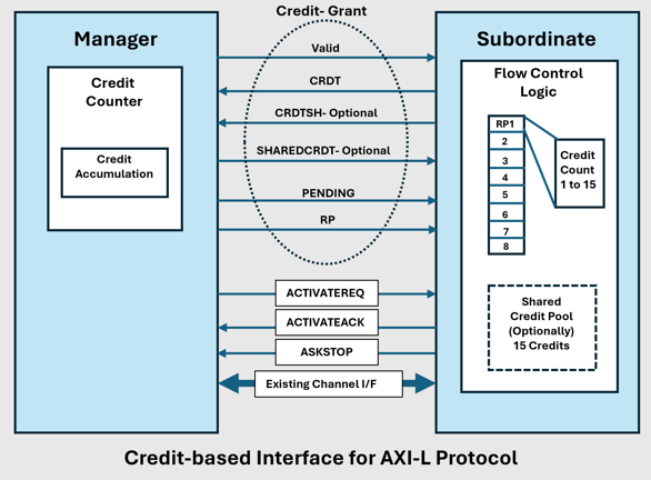

AMBA has introduced a new property named AXI_Transport in the AXI5 specification. By default, this property is set to use the traditional VALID/READY handshake mechanism. However, when explicitly configured by the user, it enables the new credit-based transport mechanism. This feature is applicable only to AXI5 and is not supported in earlier versions of the AXI protocol. It is important to note that when the credit-based transport is enabled, the wakeup_signal is not supported.
The flow control rules for the credit-based mechanism are defined in the AMBA specification:
  • The minimum number of credits that a receiver can allocate is 1 per Resource Plane (RP).
  • The maximum number of credits that a receiver can allocate is 15 per RP, along with an additional 15 shared credits.
To maintain transaction integrity, the following constraints apply:
  • For any given write transaction, the AW (Write Address) and W (Write Data) channels must use the same RP number.
  • The B (Write Response) and R (Read Data) channels are restricted to a single RP, ensuring consistent response routing.
Additionally, channels that support multiple RPs may optionally implement shared credits. This mechanism enhances buffer utilization efficiency, particularly in scenarios where throughput varies across different RPs. AXI-L explicitly supports shared credit compatibility, allowing for more flexible and efficient flow control in complex system designs.
