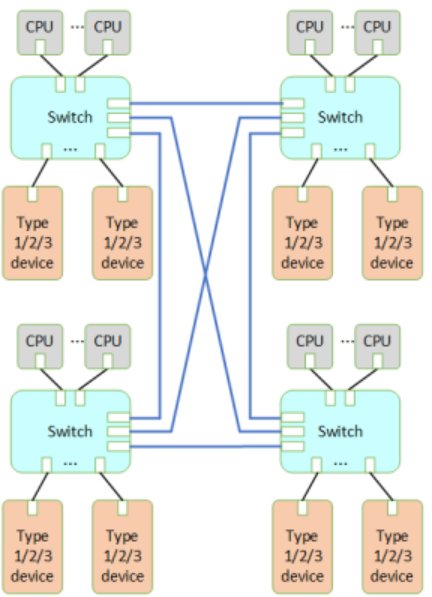

Switch Topology and CXL Fabric 
CXL Switch provides a way to expand PCIe/CXL hierarchy by adding multiple devices. A device that enables a CXL fabric, allowing multiple hosts to connect to a pool of multiple CXL devices. Essential memory pooling supports up to 4,096 nodes, each able to communicate with one another via a PBR addressing mechanism.
 Figure 1: CXL Switch

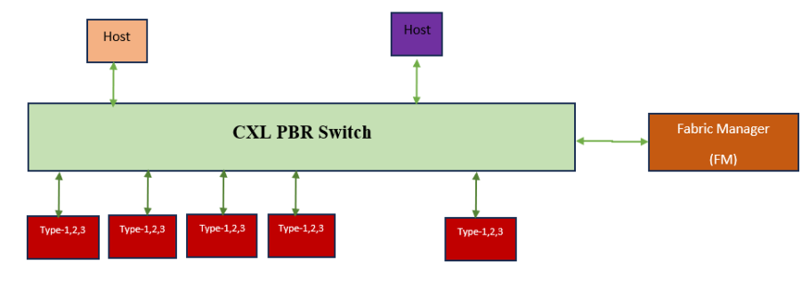

Port-Based Routing (PBR)
Port-Based Routing is a route-based on the Port ID. A PBR switch requires an assigned PID to send and receive management requests, responses, and notifications. Transactions that target this PID are processed by a switch. Switches are managed by the Fabric Manager. 
Figure 2: CXL PBR Switch with Fabric Manager

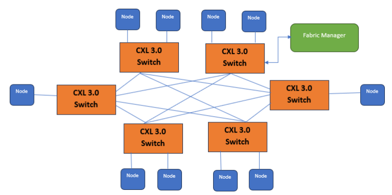

PBR Routing at the Mesh Topology 
In a mesh topology, a CXL switch can connect to multiple other CXL switches, providing redundant paths and better load balancing. It enables a truly composable infrastructure, where resources can be dynamically configured and reconfigured without the hierarchical constraints of PCIe. Enables non-tree (mesh, ring, spine-leaf) Topologies: HBR largely restricted CXL fabrics to tree-like structures. PBR breaks this limitation, allowing CXL switches to form complex fabric topologies like mesh, ring, or spine-leaf networks.  
 Figure 4: CXL Switch Mesh Topology 
