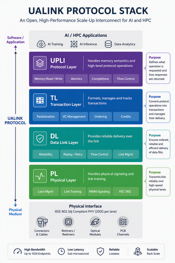

The UALink Layered Architecture
UALink is organized as a four-layer stack:
Each layer serves a distinct function, from protocol transactions at UPLI to reliable transport, replay handling, and physical communication at the lower layers.
Because development often progresses layer by layer, customers rarely verify a complete stack from day one. Depending on project needs, verification may target individual layers, partial-stack implementations, full-stack designs, or custom partitions.
As a result, verification environments must accommodate a variety of implementation boundaries and DUT to efficiently support the full development lifecycle of a UALink design.

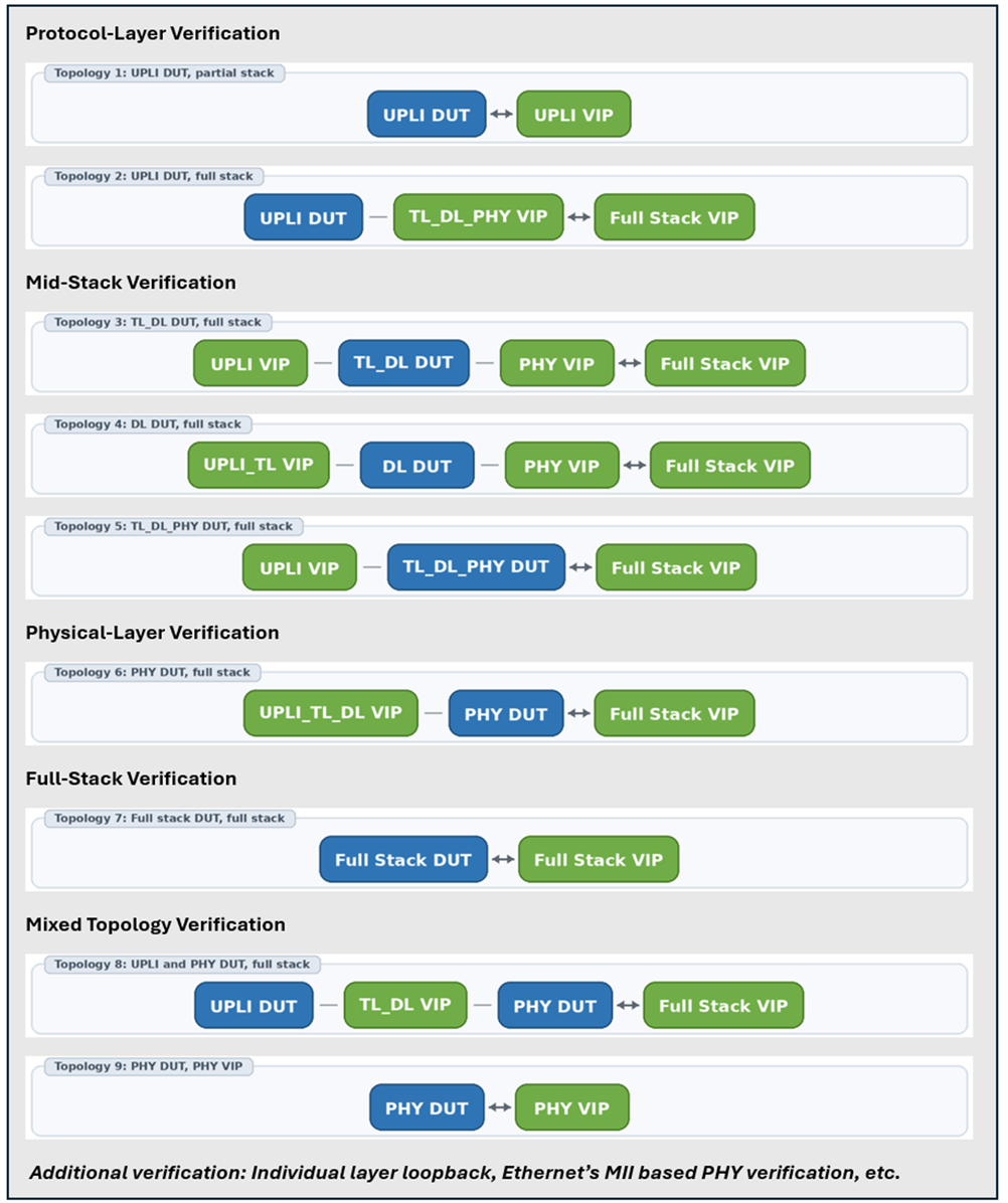

One VIP for Every UALink Design Configuration
In addition to standard interfaces, Cadence UALink VIP architecture is flexible enough to support implementation-specific environments and custom integration flows, allowing it to fit naturally into customer verification infrastructures. A key differentiator of the Cadence UALink VIP is its flexibility to adapt to any verification interface. It supports a large number of topologies including but not limited to the ones shown in the figure below:
UALink Verification Topologies
