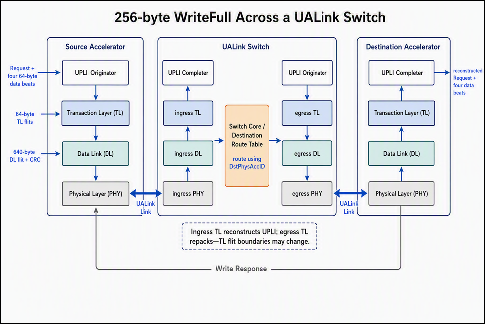

Consider one such transaction. A 256-byte result leaves accelerator A as one WriteFull request and four data beats. At accelerator B, the same request and data beats emerge. In between, however, the transaction is split, packed, routed, repacked, and reconstructed. The layer responsible for preserving its meaning throughout that journey is the UALink Transaction Layer (TL).
UALink TL transforms, transports, and reconstructs a 256-byte WriteFull.

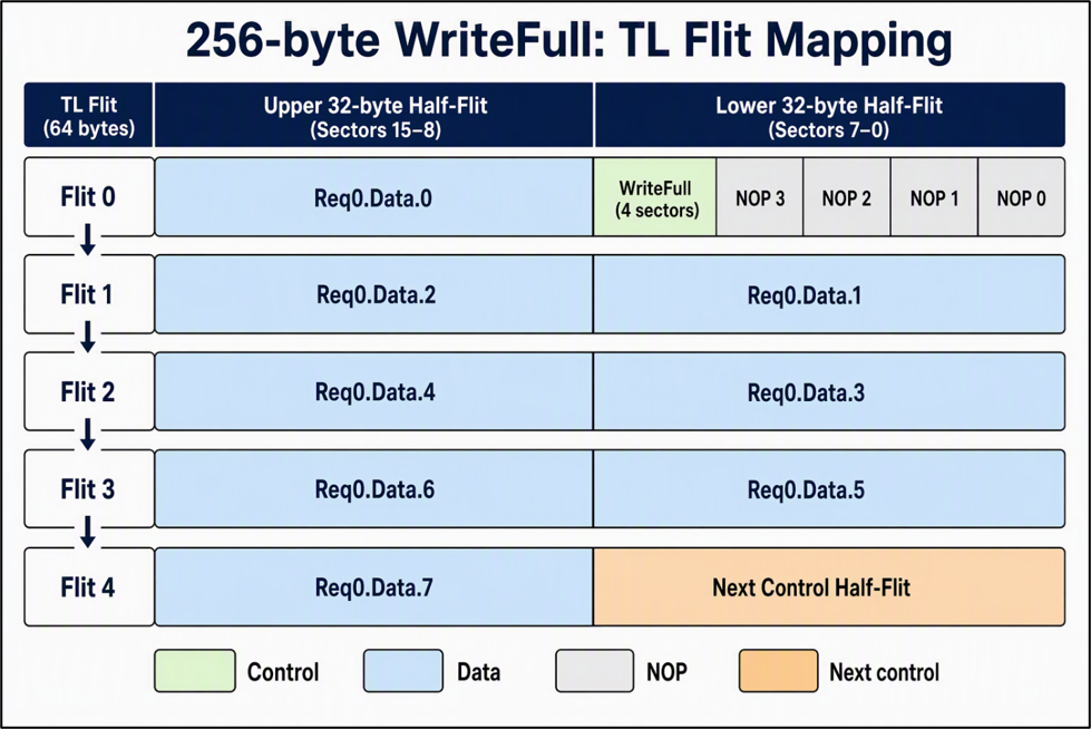

TL Builds the Flit Sequence
Tx TL places the WriteFull request in a control field and splits the 256-byte payload into eight 32-byte data half-flits. The control field tells Rx TL what transaction is coming and how much data belongs to it. Because WriteFull marks every byte as valid, no separate byte-enable half-flit is needed.
One possible mapping of a 256-byte WriteFull into TL control and data half-flits.

TL Preserves the Transaction Across the Fabric
At the switch, the ingress TL reconstructs the WriteFull request and its associated data beats. The switch core uses the destination accelerator ID to select the outgoing port, and the switch egress TL builds a new flit sequence for the next link. Flit packing may change, but the request and its associated data must remain correctly sequenced and associated.
Rx TL Reconstructs the Original UPLI Transaction
Rx TL decodes the WriteFull control field, knows that eight data half-flits belong to the transaction, and collects them in sequence. It then recreates the corresponding UPLI WriteFull request and four 64-byte data beats for accelerator B’s completer.
TL Carries Completion and Error Meaning
Completion: After completing the write, accelerator B returns a write response containing the completion status and original transaction tag. Accelerator B’s Tx TL encodes the write response, and accelerator A’s Rx TL reconstructs it so the originator can retire the correct request.
