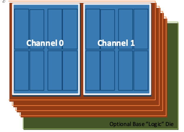

HBM History
HBM started as an answer to the requirement of higher-width GDDR memory devices, which can help with the higher bandwidth and performance needs while keeping the core device architecture still a DRAM with deterministic latency for Read/Write accesses. This new family of DRAMs was designed to work closely with GPUs that are used for graphics and other compute-intensive tasks. The first HBM device standard, JESD235, was published by JEDEC in October 2013.
HBM4
HBM4 is the latest generation of device standard for HBM devices. HBM4 devices have improved on several major features as compared to the previous generation of HBM devices. Some of the important changes are listed below:
I/O and DRAM Core Voltage
HBM4 core DRAM voltage has been reduced to 1.05V, with I/O voltage left to vendors to decide. This is a significant improvement over the 1.1V needed for both the DRAM core and I/O for previous-generation HBM3 devices. This helps with better power efficiency for HBM4 devices.
Channels
HBM4 supports upto 32 channels, which is double the number of channels that was possible with HBM3. This is important performance improvement as the number of core per CPU/GPU has gone up.
