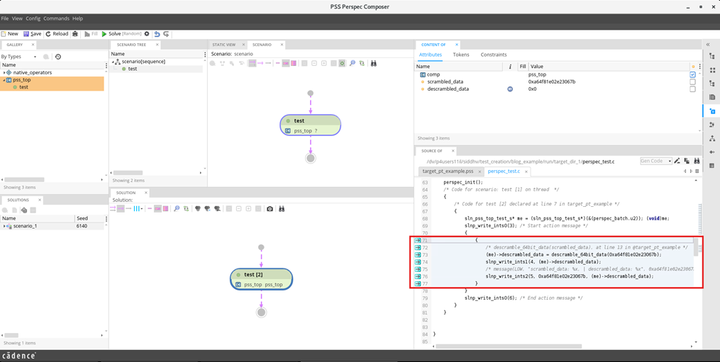

Another example where a c implementation is present in the exec body. If you need the descramble_64bit_data functionality on the target platform and already have its implementation in C, there's no need to redevelop it in PSS. You can directly reuse existing functionality available in C, as demonstrated in Example 1.2.
Example 1.2: Import Function on Target Platform

Composer View of Example 1.2: The Highlighted Part of the Snapshot Shows a Functional Call in the Generated C Code in the Perspec Composer Window
The descramble_64bit_data function is declared within the PSS model. It accepts 64-bit scrambled data as input and returns the corresponding 64-bit descrambled data. Since this function is implemented specifically for a target platform, it can only be invoked inside target execution blocks. For this reason, it is called within the exec body.
The exec declaration block contains the C implementation of descramble_64bit_data. Additionally, this function internally calls other C functions, which are also defined within the same exec declaration block.

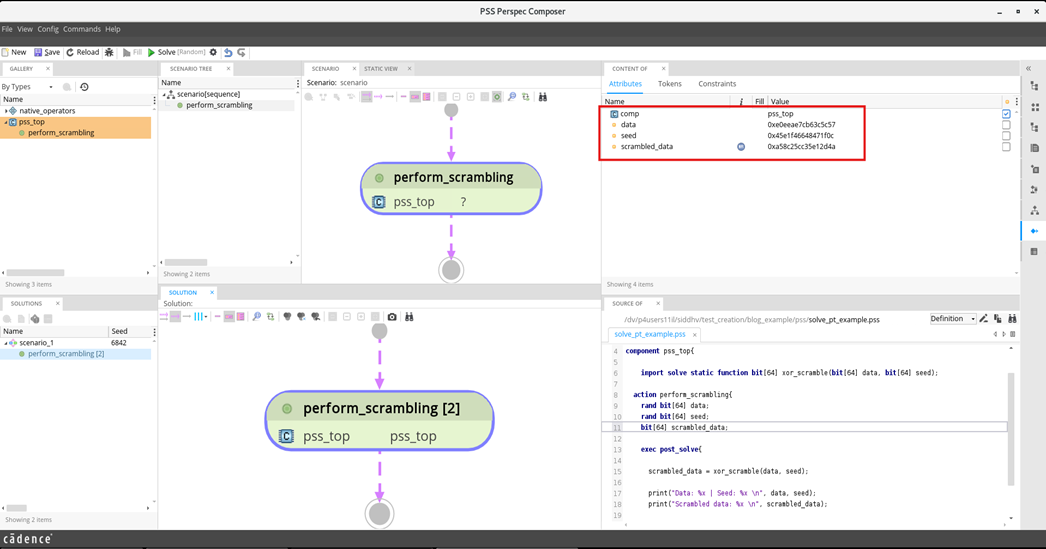

Let’s take an example where the PSS model requires the logic for xor_scrambling, and you already have an implementation available in C, there’s no need to rewrite it from scratch. You can simply reuse the existing C code within the PSS model, as demonstrated in Example 2.1.
Example 2.1: Import Function on Solve Platform

Composer View of Example 2.1: Highlighted Portion of Snapshot Showing Input Values and Output Value After Function Call at Perspec Composer Window
The import solve function xor_scramble is defined with input arguments like 64-bit data and a seed, and returns scrambled data. The xor_scramble function is declared on the Solve platform, and its C-language implementation is already available. This shows that any functionality previously developed in another programming language can be seamlessly reused.
As shown in the above examples, if you want to reuse functionality that already exists in a foreign language and make it available on the target platform within a PSS model, you can achieve this by leveraging exec blocks and using functionality present in separate external libraries. These allow you to integrate and invoke platform-specific implementations, enabling seamless reuse of existing code without rewriting it from scratch.
