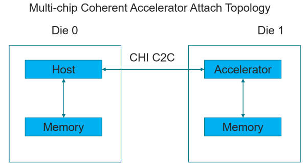

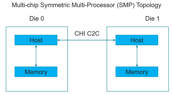

The CHI C2C protocol can be used to enable communication in chip-to-chip as well as chiplet-to-chiplet applications. The supported topologies include the Multi-Chip Symmetric Multiprocessor (SMP) topology, where a number of functionally similar chiplets perform coherent processing, as well as the Coherent Accelerator topology, which enables connection of an I/O coherent or fully coherent device to the system host.
