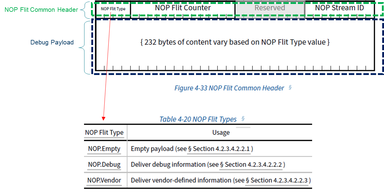

NOP Flit Payload Structure and Types
A NOP Flit Payload comprises a one Double Word (DW) NOP Flit Common Header, and a NOP Flit Type Payload section. The NOP Flit Type Payload content varies:
  • NOP.Empty Flit: The most basic type, containing a payload of all zeros. It's primarily for padding and alignment.
  • NOP.Debug Flit: Carries debug information organized into Debug Chunks, each with a header and a vendor-defined payload.
  • NOP.Vendor Flit: Enables vendors to define their own proprietary payload formats for vendor-specific debug information.
