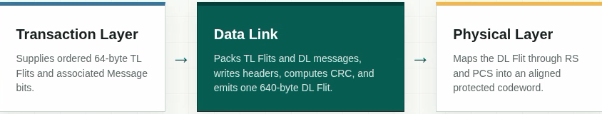

UALink's Data Link Layer (DL) faces a remarkably similar challenge. A DL flit must carry different types of information while allowing the receiver to identify what starts where, what is continuing from before, and whether everything arrived correctly. To understand how UALink achieves this, let's first examine the structure of a DL flit and the roles played by the flit header, segment headers, and flit packing rules.
A block diagram illustrating data flow across three protocol layers: the Transaction Layer supplying 64-byte TL Flits, the Data Link layer packing them to emit a 640-byte DL Flit, and the Physical Layer mapping it into an aligned protected codeword.
Figure 1: Flit flow across TL, DL, and PHY
3 B Flit Header + 5 B Segment Headers + 628 B payload arranged as SP0(128B), SP1(128B), SP2(128B), SP3(124B), SP4(120B) + 4 B CRC = 640 Bytes

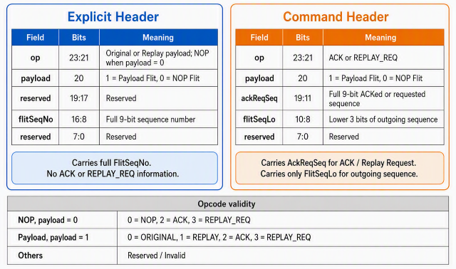

Flit Header
In our cargo-train analogy, the flit header is like the record book carried by the engine, helping the receiver identify the arriving train, track its sequence, and confirm deliveries moving in the opposite direction. The flit header actively manages two conversations at once through either the explicit or command format.
  • The explicit header uses a 9-bit FlitSeqNo to state exactly which sequence is currently transmitting or restarting during a replay.
  • The command header handles both directions simultaneously, pairing 3-bit FlitSeqLo (the compressed outgoing sequence number) with AckReqSeq, which acknowledges safely received data or targets a specific replay.
    • This dual-purpose design makes UALink highly efficient compared to protocols like UCIe retry; instead of wasting bandwidth alternating between separate sequence and Ack/Nak flits. UALink tightly packs both the outgoing sequence state and the incoming acknowledgment into one fast-moving header.
Figure 2: Types of flit headers

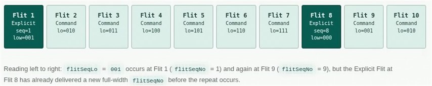

But if normal command flits only carry a 3-bit compressed sequence number, how does the receiver avoid losing track? The challenge is that three bits wrap around every eight flits. Without a solid reference point, a value like '001' quickly becomes ambiguous—does it mean sequence 1, 9, or 17? The answer lies in occasionally dropping an anchor.
To prevent this confusion, UALink periodically inserts an explicit header carrying the full 9-bit sequence value. This provides a fresh, unambiguous baseline, allowing the receiver to safely piece together the true sequence numbers for all the compressed command flits that follow.
Figure 3: Explicit flit interval and sequence anchoring
So, is this explicit flit rate a strict, unbreakable rule? Not exactly. While they normally appear at set intervals to keep the receiver anchored, a replay request changes everything. If data is lost, reliability takes priority. The transmitter doesn't wait for the next scheduled explicit flit. Instead, it immediately breaks the interval, firing off an explicit flit with a REPLAY opcode to instantly restore the context and restart the stream from the requested point.
But how do these 9-bit sequence numbers actually count? Interestingly, UALink doesn't treat the entire 0-to-511 numerical range equally. During link initialization, when the system is only sending NOP flits, the sequence number parks at a default value of 511. Once real data starts flowing, the counter wraps directly from 511 to 1, kicking off the normal payload sequence. From then on, payload Flits cycle through 1 to 511, while the value 0 remains strictly reserved and never used. And if a NOP flit drops into the middle of normal traffic? It simply inherits the FlitSeqNo of the previous flit, ensuring the sequence number never increases until the next actual payload arrives.

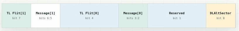

Segment Header
If the flit header is the engine's record book, the segment header is like the label attached to a cargo coach. It doesn't describe every box inside the coach—it simply tells the receiver what new shipment begins there. Each segment has one small header byte:
  • DLAltSector marks a DL-to-DL message in the first sector.
  • TL Flit[0] and TL Flit[1] mark new TL flit starts.
  • Two message fields carry metadata only when the matching TL Flit start is present.
The important point is that the segment header marks start, not lengths. Once a 64-byte TL flit starts, the receiver simply counts 64 bytes to rebuild it. If a segment only carries continuation from an earlier TL flit, there is no new start to mark. So the same header byte can describe a DL alternative sector, one new TL start, two new TL starts, or no new start at all. That keeps decoding simple even when TL data, DL messages, and carry-over share the same segment.
Figure 4: Segment header

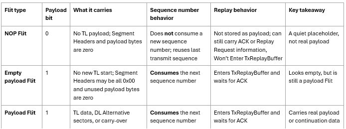

At this point, one subtle distinction matters: a flit can be a true NOP, an empty payload, or a payload carrying TL data/carry-over. The difference is not how empty it looks, but whether it consumes a sequence number and enters replay tracking.
Figure 5: NOP flit vs empty payload flit vs payload flit
This distinction is important because all-zero segment headers do not automatically mean NOP. If the payload bit is set, or if continuation data is present, the flit remains a payload flit and must be handled through the normal sequence and replay path.

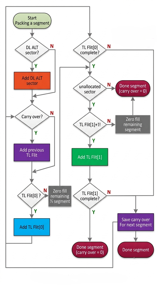

The Core Flit Packing Rules
Now imagine the workers loading each coach. To avoid confusion at the destination, they must follow a strict loading order: company cargo first, unfinished shipments next, and then new customer shipments. In UALink, these loading rules are known as the flit packing rules.
  1. DL alternative sector: DL message is present, it claims absolute priority and locks into the very first sector(4 bytes).
  2. Carry-over bytes: Unfinished remainder of a TL flit spilling over from the previous segment or flit. (ranging 4 to 60 bytes).
  3. TL Flit[0]: The first brand-new TL flit start in the segment.
  4. TL Flit[1]: The second brand-new TL flit start in the segment.
Because this rigid rule prioritizes speed, several fascinating corner cases emerge.
  • The segment header can announce at most these two new TL-flit starts
  • First, a new 64-byte TL flit doesn't need a massive opening; as long as just one unallocated 4-byte sector exists, it will start packing, letting the rest naturally spill into the next segment as carry-over.
  • Furthermore, the packer refuses to stall: if data for TL Flit[0] isn't ready on the first clock tick, it mercilessly zero-fills that half-segment. If TL flit[1] shows up on the second tick, it immediately starts packing.
  • Even if all segment headers read 0x00 (indicating no new starts), the segment might still be crammed with carry-over data, meaning it must strictly remain a payload flit and never be converted into a NOP.

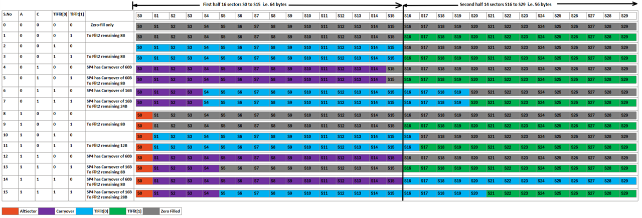

  • If a 4-byte alternative sector and 60 bytes of carry-over perfectly consume the entire first half of a segment, the very first new TL flit squeezing into the second half is still designated as TL Flit[0], simply because it is the first new arrival for that segment. Refer to S.No 14 from figure 7.
Figure 6: Flit packing flow chart
From Rules to Packing Outcomes
Once the priority chain is clear, the next natural question is what the packer can actually produce inside a segment. The answer comes from four visible outcomes: whether a DL Alternative sector starts, whether carry-over is already waiting, whether TL Flit[0] begins, and whether TL Flit[1] begins. Together, these outcomes create sixteen possible packing patterns. The Figure-7 below captures those sixteen possibilities, using Segment 4( 0-indexed), the last segment, which provides 120 bytes or 30 sectors of payload space.
Figure 7: Packing outcome visual map
