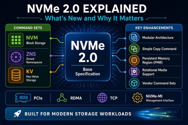

Non-Volatile Memory Express (NVMe) has become the dominant protocol for high-performance storage across client SSDs, enterprise drives, and hyperscale data centers. With NVMe 2.0, the specification expands beyond traditional block-based SSD access with new command sets, broader media support, improved transport organization, and enhancements for modern deployments. This post explores what is new in NVMe 2.0, why these additions matter, and how they impact storage architects, implementers, and verification teams.
Diagram showing NVMe 2.0 modular specification architecture with Base Specification at the center, connected to three Command Sets (NVM Block, ZNS, KV) and three Transports (PCIe, RDMA, TCP), alongside NVMe-MI for management. Four key enhancements are highlighted: Simple Copy, Rotational Media, Vendor Command Sets, and Persistent Memory Region. A Who Benefits section lists Cloud/Hyperscale, Database/KV, Storage Vendors, Enterprise IT, and Automotive/Edge.

1. Modular Specification Architecture
NVMe 2.0 breaks the monolithic spec into a family of focused documents:
Document Purpose
NVMe Base Specification Core architecture, admin commands, queuing model
NVMe Command Set Specifications NVM (block), ZNS, KV command sets - each independent
NVMe Transport Specifications PCIe, RDMA, TCP - each independent
NVMe Management Interface (NVMe-MI)  Out-of-band device management
Why it matters: An implementer building a ZNS SSD over TCP can focus primarily on the Base specification, ZNS command set, and TCP transport specification instead of navigating one large monolithic document. Under NVMe 1.4, a single errata or feature addition required revising the entire specification, coordinating across all stakeholders.
Under 2.0:
  • A new transport can be standardized as an independent document instead of being folded into one monolithic specification.
  • A new command set, such as computational storage or other emerging models, can evolve through its own specification.
  • Spec revisions are scoped - a change to ZNS doesn't require re-review of the NVM command set or TCP transport.
