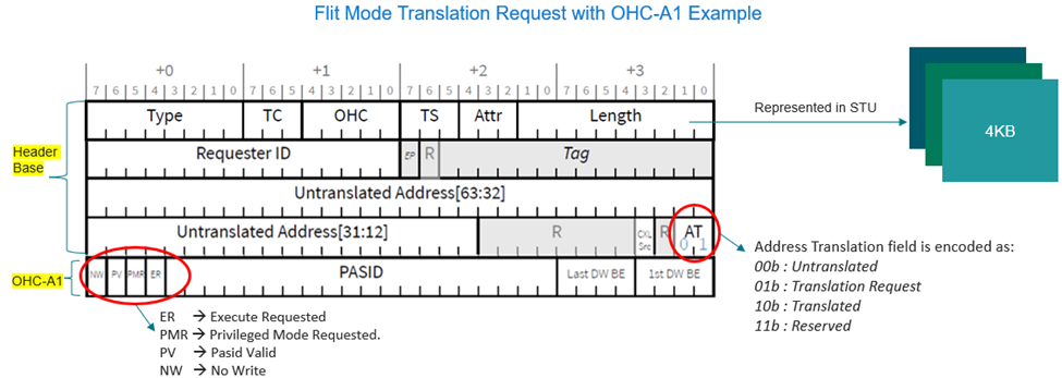

Translation Request Format
The translation request format is like a memory read in both Non-Flit Mode (NFM) or Flit Mode (FM), where Address Type (AT) bits identify that it is going to be a translation request. In FM, the Orthogonal Header Content (OHC) encoding adds OHC-A1 Double Word (DW) in the packet header, including information like No Write (NW), explicit byte enables and/or Process Address Space ID (PASID) fields. These translation requests are not Direct Memory Access (DMA) transactions.

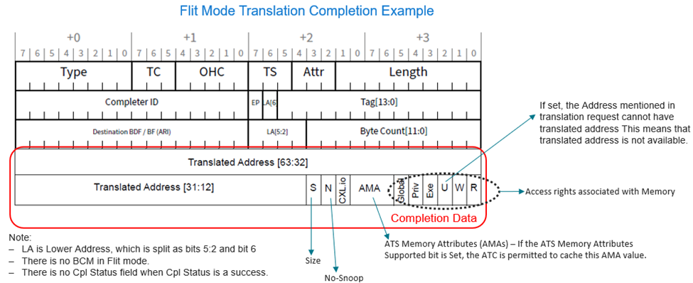

Translation Completion Format
The translation completions format is like the data completions. For a translation completion, the Relaxed Ordering (RO) bit is applicable and permitted to be set if the corresponding translation request RO bit was set. Completion ata contains:
  • Translated address
  • Size (or pages in terms of Smallest Translation Unit (STU))
  • Memory protection attributes (Global, Priv, Exe, U, W, and R)
Completion can have multiple translated addresses. If the TA was not able to perform the requested translation, the completion with no data (Cpl) must be returned. The OHC-A5 DW in the packet header is required for unsuccessful completions and for completions with lower address [1:0] not equal to 00b.

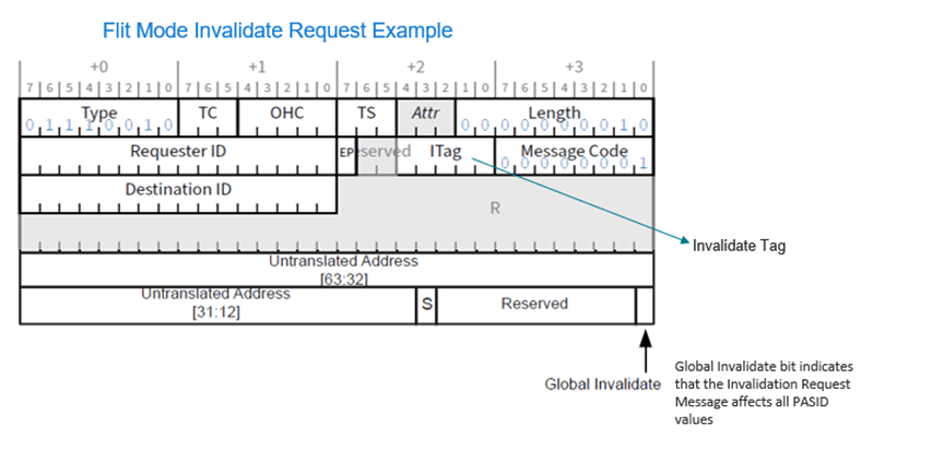

Invalidate Request
An invalidate request clears a specific subset of the address range from the ATC when translation is changed in TA. The invalidate request is a message with a data transaction with 64 bits of data. The message payload contains the untranslated address range to be invalidated, and the ITag field is used by the TA to uniquely identify invalidate requests. In FM, PASID is included when OHC-A4 DW is present and the PV bit is set.

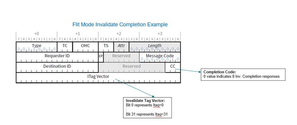

Invalidate Completion
An invalidate completion is a message transaction that must contain the requester ID used in the associated invalidate request. All fragments of an invalidate completion must have an identical request ID, Completion Count (CC), and ITag vector fields.
