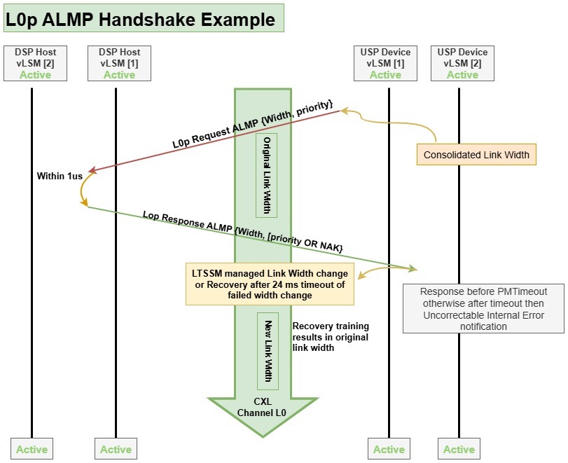

How L0p Works
  1. Initiation: Either side (root or endpoint) can initiate a lane width change.
  2. Negotiation: A new L0p ALMP packet is used to send a request (e.g., downsize from x8 to x4).
  3. Acknowledgment: The partner device responds with L0p ALMP ACK or NAK within a defined time (e.g., 1 µs).
  4. Lane transition:
    • Downsizing: Inactive lanes send EIOSQ and go to electrical idle.
    • Upsizing: New lanes are trained and brought online.
  5. Traffic continuity: Active lanes continue transmitting FLITs during the transition.
