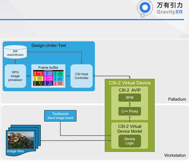

The Palladium Emulation Platform supports co-verification—bringing hardware and software together to build a fast, flexible, and thorough environment for XR chip verification. The designed flow supported:
  1. Integration of virtual device models with Accelerated VIP (CSI-2)
  2. Flow from testbench → image files → AVIP → DUT
  3. Hybrid verification (workstation + Palladium)
Some of the highlighted feature set:
  • Emulation Performance: Palladium enables MHz emulation runs that support different XR chip configurations and give near real-time feedback by deploying AVIP CSI and DSI for virtual protocol debugging. This means engineers can catch issues early and fix them faster.
  • FullVision Debug: It helps automate a lot of the debugging workflow, which saves a ton of time. Instead of manually hunting down bugs, the emulation with FullVision Debug can help pinpoint the source of issues quickly.
  • System-level Coverage: It doesn't just check if hardware and software work together—it digs deep into performance, interface behavior, and potential problem areas to make sure everything is solid.
Image-based stimulus injected into the CSI-2 interface (AVIP) during emulation using Palladium Emulation.
