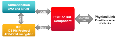

The CXL 3.0 and CXL 3.1 specifications build on the security features of the CXL 2.0 IDE module, incorporating key elements from PCIe 6.0, particularly within the CXL.io channel. These specifications define mechanisms for data encryption and integrity protection in the CXL.CacheMem channel. This article will focus on the CXL.CacheMem IDE concept.
Figure 1: Functionality of IDE
