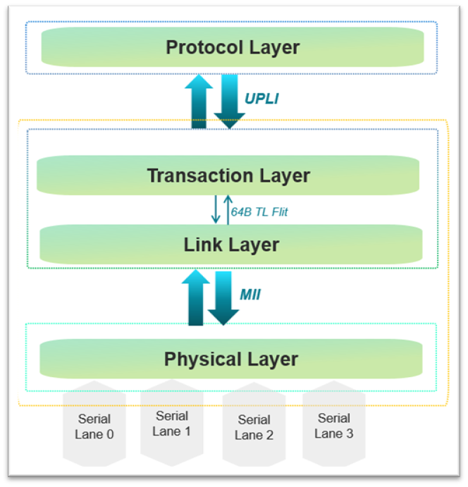

UALink presents a non-coherent interconnect solution, leveraging a 200G Ethernet Physical Layer (PHY) across four lanes to achieve 800 Gbps per port. Notably, the upper lanes are optimized to cater to requirements of scale-up applications.
UALink is designed as a layered protocol stack comprising four distinct, well-defined functional layers:
  • Protocol layer: Simple symmetric protocol interface for data and control exchange
  • Transaction layer: Defines 64B Flit packing, packet formats, and flow control mechanism
  • Data Link layer: Contains error recovery features including Flit replay and RAS (Reliability, Availability, and Serviceability) features
  • Physical layer: Based on 802.3dj ethernet PHY with some defined modifications

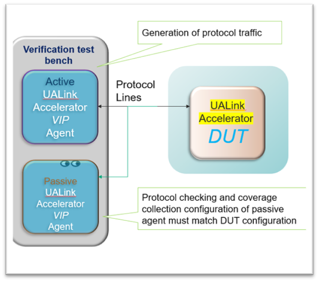

UALink VIP adheres to a layered architecture as defined by the protocol, offering flexibility to users. This modular architecture enables the utilization of the VIP at the block and stack level. VIP provides callback support and error injection at logical protocol touchpoints for easy debug, coverage, scoreboarding, and other testbench requirements. The below figure shows a reference verification topology with VIP.
