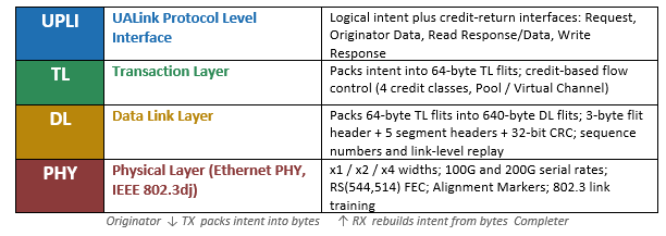

The Stack, From Intent to Wire
A UALink transfer is a relay race across four layers:
Figure 1 - The UALink Protocol Stack
A transaction descends one side of the stack and ascends the other. Each layer transforms what it receives.
At the top, UPLI works in terms of intent: read, all-channel context that the transaction layer must preserve.
End-to-end credit flow is already visible here. The UPLI interface has request, originator data, read response/data, and write response channels, each paired with credit-return signaling. Those credits are per port and per UPLI channel: after a reset, the sender starts with no credits, and the receiver issues the initial credits before normal traffic can flow. That is why a full-stack test cannot treat UPLI as "just commands"; the command/data beats and the credit-return interfaces form the first handshake that decides whether the transaction can even enter the stack.

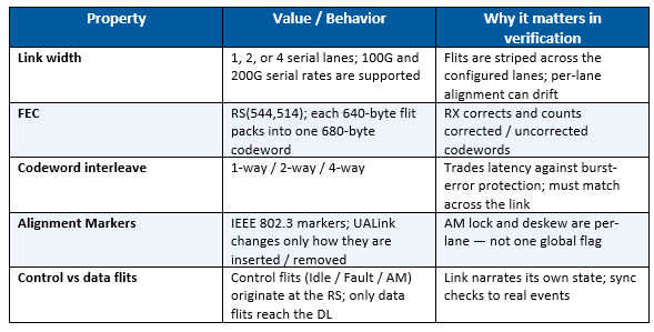

Below the Flit: Lanes, Markers, and Link Integrity
Beneath the data link layer, the physical layer maps each 640-byte flit into a single RS(544,514) codeword and distributes it across the configured link width — one, two, or four serial lanes. Here, UALink is no longer a protocol on paper but a signal on a wire, and it borrows its PHY directly from IEEE 802.3 Ethernet.
Figure 5 - Physical Layer at a Glance
