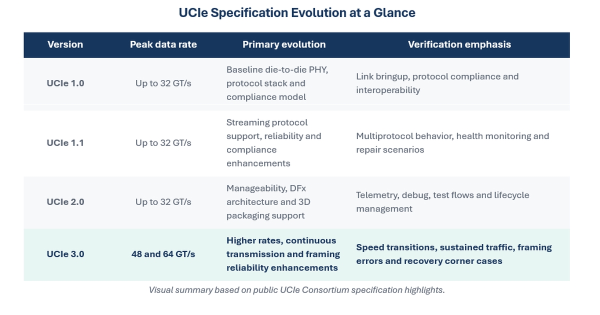

The chiplet ecosystem continues to push performance boundaries, and the latest UCIe 3.0 specification takes a significant step forward with the introduction of 48 GT/s and 64 GT/s data rates, alongside enhancements to support continuous transmission protocols and improved framing error detection and correction capabilities. Together, these features represent much more than a simple speed upgrade. They fundamentally expand the scope of workloads that can efficiently leverage UCIe-based connectivity.
More Than Just Higher Bandwidth
The move from previous generations to 48 GT/s and 64 GT/s significantly increases die-to-die bandwidth, enabling chiplet-based systems to transfer data at unprecedented rates. For AI training clusters, inference accelerators, memory-centric architectures, and large-scale compute fabrics, this additional throughput helps address one of today's biggest bottlenecks: data movement.
However, higher bandwidth brings new challenges. As bandwidth scales, the tolerance for implementation issues shrinks. Small protocol violations, corner case timing interactions, or recovery sequence bugs that might have gone unnoticed at lower speeds can manifest as level failures in complex chiplet deployments.

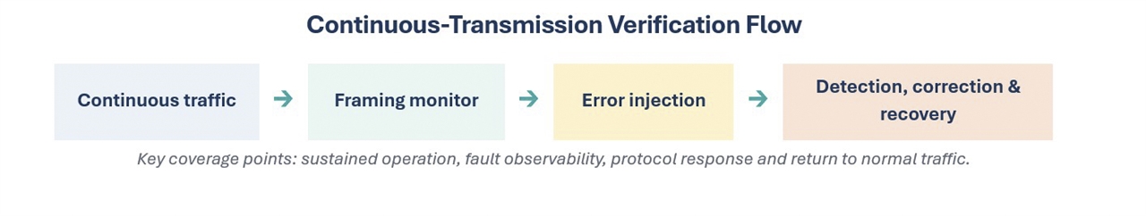

Why Advanced VIP Matters
This is where a comprehensive verification solution becomes critical. Cadence UCIe VIP provides a protocol-aware verification environment that enables engineers to validate both mainstream and advanced UCIe 3.0 features efficiently.
For higher speed operation, the Cadence UCIe VIP helps verify link training, speed negotiation, protocol compliance, and data integrity across supported data rates. For continuous transmission use cases, the VIP can generate realistic traffic patterns, exercise streaming scenarios, and validate system behavior under stress conditions.
Equally important, the Cadence UCIe VIP provides extensive error injection and protocol checking capabilities, enabling teams to verify framing error detection, correction, recovery behavior, and overall protocol robustness before silicon.
By combining automated protocol compliance checking, comprehensive coverage collection, configurable traffic generation, and interoperability-focused verification, engineers can focus on uncovering corner case issues rather than building complex verification infrastructure from scratch.
