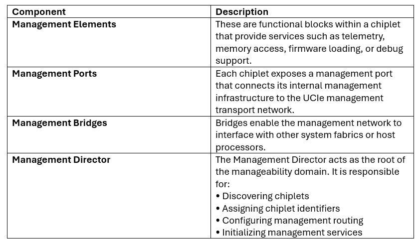

Core Components of Manageability Architecture
At a high level, UCIe manageability defines a distributed management infrastructure composed of several architectural elements.

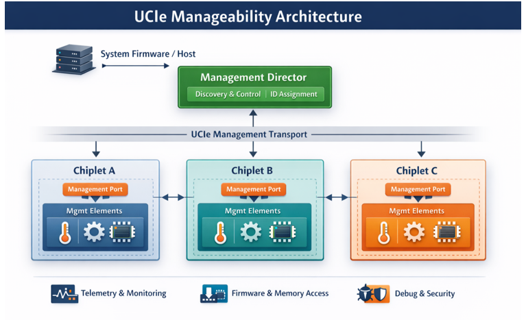

Conceptually, the architecture can be visualized as a management network connecting chiplets across the package:
How Management Communication Works
UCIe defines a dedicated Management Transport protocol that enables communication between management entities across chiplets.
Each management entity is identified by a Management Network ID, composed of:
  • Chiplet ID
  • Entity ID
This addressing scheme allows management messages to be routed to any management element across the package.
The transport packets carry requests and responses for different management protocols, including memory access operations and vendor-defined services.
