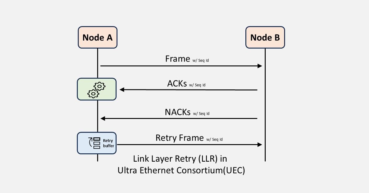

How UEC-LLR Works
In layman’s terms,
  • Frame transmission with sequence numbering: Every frame between nodes is tagged with a local sequence number, and these sequence numbers/IDs are not visible to the upper layer.
  • Frame Buffering: The sender buffers the sent frames in a local retry queue and holds them in a local buffer until the receiver acknowledges them.
  • Acknowledgment: The receiver will send the ACKs back to the sender once each frame is received successfully.
  • Loss detection: If a frame is dropped or corrupted, the receiver will notice a gap in the sequence number and send the Negative Acknowledgement (NACK) back to the sender. In other cases, if the sender does not receive an ACK or NACK within a time frame, it will initiate a timeout-based retry.
The sender retransmits only lost/corrupted frames from the local retry buffer, avoiding transport-level retransmission. Once the Sender receives the ACKs, it will remove the entries from the local retry buffer.
