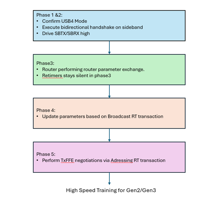

Router: Lane Initialization
USB4 lane initialization is divided into five phases, where routers control link configuration and parameters synchronization across the topology.
Figure 1: Five-stage lane initialization
  • Phase 1 and Phase 2 – Electrical Initialization: Sideband signaling is used to establish USB4 mode, lane orientation, polarity, and electrical readiness. Retimers forward these signals to maintain continuity across the link.
  • Phase 3 – Capability Exchange (Router Controlled): Routers exchange capability information such as supported link speeds, lane bonding configuration, and adapter capabilities. During this phase, the retimer does not actively participate in protocol decision-making and remains transparent, forwarding sideband transactions without modification.
  • Phase 4 – Parameter Distribution (Broadcast RT): Routers distribute final link parameters using Broadcast RT transactions, including link speed and lane configuration. Retimers update their internal configuration based on these broadcasts and propagate them across their upstream and downstream ports to ensure consistency across the topology. When a Retimer detects an LT_Resume Transaction on any USB4 Port, it shall transition to phase 5.
  • Phase 5 – Equalization (TxFFE Negotiation): Equalization is performed using addressed RT transactions between directly connected link partners. TxFFE parameters are negotiated independently for each segment, allowing per-hop optimization before high-speed training.
Retimers detect the receiver SLOS symbol and begin transmitting CL_WAKE1.X using a local clock once Rx Active is detected. After completing training across all segments and meeting the required clock switch conditions, the retimer transitions from the local clock to the recovered clock. It then stops generating training symbols and begins forwarding the received bit stream, moving the link into steady-state data operation.

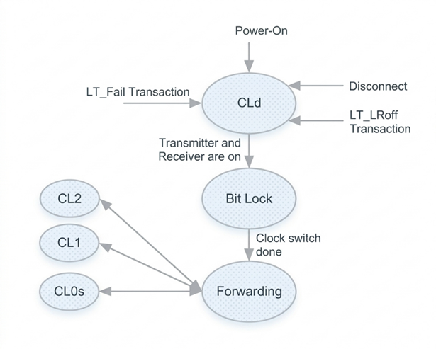

Retimers: Channel State Machine
The retimers follow a channel state machine that aligns with the router-driven link initialization and training flow, tracking receiver activity and adapting as the link progresses. They align with the incoming signal and transition toward stable data transfer as training completes. As shown in the figure below, this sequence ensures proper synchronization before steady-state data forwarding.
Figure 2: Retimer channel state machine
  • CLd (Channel Detect): State where retimers wait for receiver activity and detect the presence of a valid signal on the channel.
  • Bit Lock: Retimers enter this state once activity is detected on the receiver side. In this state, the receiver achieves clock/data recovery (CDR) and ensures reliable sampling of the incoming data, enabling proper Rx equalization and further link training progression.
  • Bit Forwarding: In this state, retimers use the recovered clock and forward the received bit stream directly from receiver to transmitter without modifying the data.
