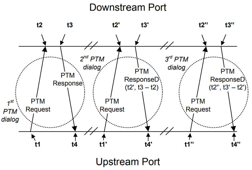

A PTM dialog is defined as a matched pair of messages consisting of a PTM Request and the corresponding PTM Response or PTM ResponseD message.
The timestamps captured during the PTM dialogs enable the calculation of the timing relationship between the PTM Requester and PTM Responder (please see the image below for reference). The value (t3-t2) measures the time consumed by the PTM Responder for a given PTM dialog. The time (t4-t1) is the time from request to response. Therefore, ((t4 - t1) - (t3 - t2)) effectively gives the round-trip message transit time between the two components, and that quantity divided by 2 approximates the Link delay - the time difference between t1 and t2.
PTM Link Protocol
  • A PTM Requester must update its stored t1 timestamp when transmitting a PTM Request Message, even if that transmission is a replay.
  • A PTM Responder must update its stored t2 timestamp when receiving a PTM Request Message, even if the received TLP is a duplicate.
  • A PTM Responder must update its stored t3 timestamp when transmitting a PTM Response or ResponseD Message, even if that transmission is a replay.
  • A PTM Requester must update its stored t4 timestamp when receiving a PTM Response Message, even if the received TLP is a duplicate.

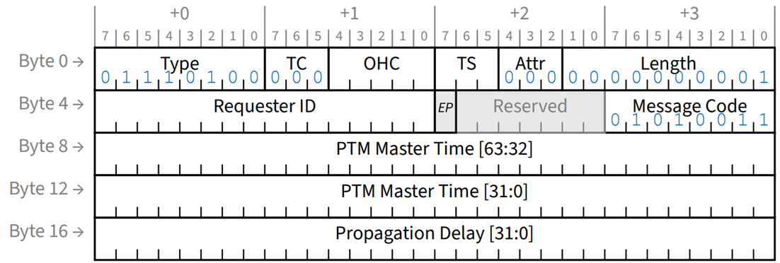

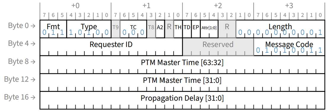

The PTM Master Time field is a 64-bit value containing the value of PTM Master Time at the receipt of the PTM Request Message for the current PTM Dialog. In the shared image, for the 2nd PTM dialog, this is the PTM Master Time at time t2'.
The Propagation Delay field is a 32-bit value containing the interval between the receipt of the PTM Request Message and the transmission of the PTM Response Message for the previous PTM dialog. In the shared image, for the second PTM dialog, this is the time interval between t2 and t3 captured during the first PTM dialog.

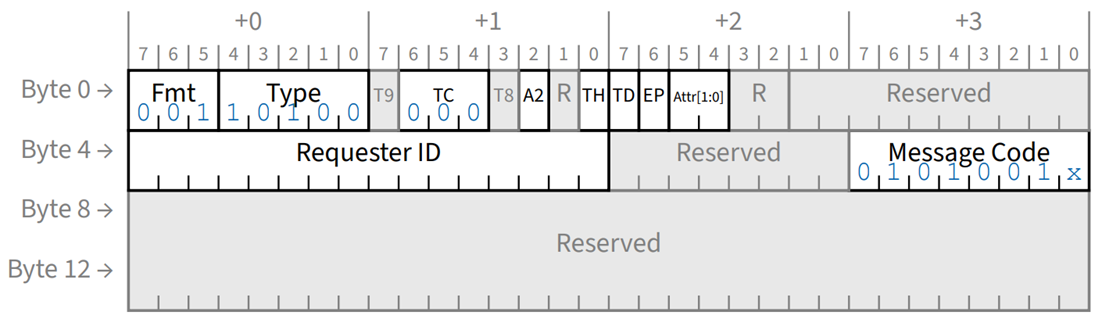

In NFM, Timestamps must be based on the STP Symbol or Token that frames the TLP, as if observing the first bit of that Symbol or Token at the Port's pins. The image below shows the PTM Request and Response Messages for Non-Flit Mode:
 PTM Request/Response Message - Non-Flit Mode
PTM ResponseD Message - Non-Flit Mode

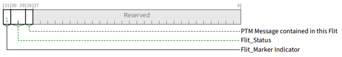

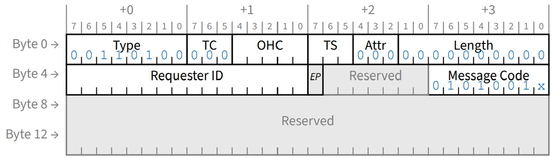

In Flit Mode, timestamps for PTM messages are measured at the Flit level rather than at the TLP level. There is the bit "PTM Message contained in this Flit" in the Flit_Marker field, which signals the presence of a non-nullified PTM Message inside the Flit. The PTM timestamps must be based on the Flit_Marker field.
The images below show the PTM Request and Response Messages for Flit Mode, and the Flit_Marker indicator:
 PTM Request/Response Message - Flit Mode
 PTM ResponseD Message - Flit Mode
 Flit_Marker

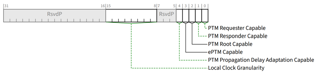

PTM Extended Capability Structure

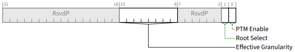

The Extended Capability structure is required for any port of the Root-Complex that supports PTM and in only one function of the Endpoint. The images below show the PTM Capability and Control registers:
 PTM Capability Register
 PTM Control Register
Enhanced Precision Time Measurement (ePTM) places additional requirements on PTM Devices. It must be implemented in all PTM devices that support Flit-Mode. Support for ePTM is indicated by the ePTM Capable bit.
