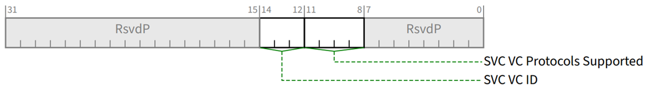

Not all Virtual Channels (VCs) support Unordered I/O (UIO) traffic. The supported protocols for each VC can be determined by examining the SVC VC Protocols Supported field (bits [11:8]) of the SVC Resource Capability Register. A value of 0010b or 0011b indicates that the VC is capable of carrying UIO traffic.

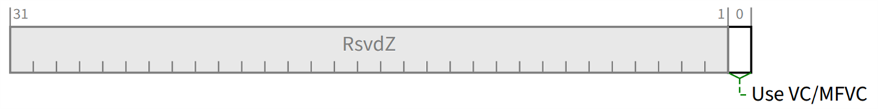

Before enabling UIO, the legacy VC/MFVC mechanism must be disabled. This is accomplished by clearing the Use VC/MFVC bit (bit 0) in the SVC Port Status Register (Offset 10h). Since this field is defined as Write-to-Clear, writing a value of 1 clears the bit and transitions the Port to SVC-based operation.

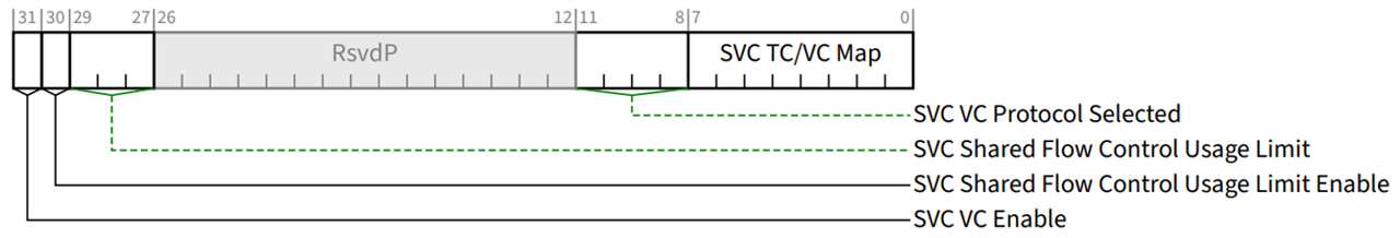

Once SVC is active, UIO can be enabled on a Virtual Channel by programming the SVC VC Protocol Selected field (bits [11:8]) in the SVC Resource Control Register to 0010b and setting the SVC VC Enable bit in the same register. This configures the selected VC to carry UIO traffic.
Traffic Classes associated with the Virtual Channel are configured through the SVC TC/VC Map field (bits [7:0]) of the SVC Resource Control Register. This field defines which Traffic Classes are mapped to the VC, allowing UIO and non-UIO traffic to be routed according to the desired fabric policy.
This configuration process enables software to establish the Virtual Channels that will carry UIO traffic while maintaining explicit control over TC-to-VC mappings across the PCIe fabric.
