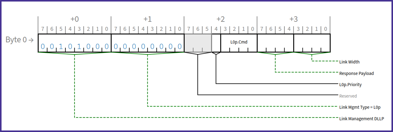

Inside the Link Management DLLP
Link management DLLP is four bytes wide with a compact but highly structured format:
Link Management DLLP is four-bytes wide with a compact but highly structured format:
The key semantic fields are:
  • L0p.Cmd: Encodes operations such as request, Ack, and Nak.
  • L0p.Priority: Indicates requests that are policy or urgency-sensitive.
  • L0p link width: Carries the requested or desired link width.
  • Response payload: Qualifies the response behavior when responding to a request.
